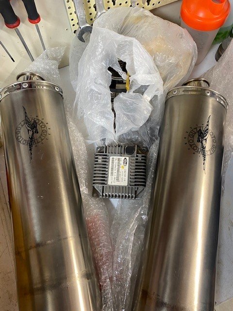

NicoNZ Posted March 21, 2021 Posted March 21, 2021 Managed to source a TI race kit someone had pulled off their bike before selling. I couldn't wait so tried installing the pipes as soon as they arrived. A little disappointed in the pipes as they have a few marks and a couple of small dings. Anyhow the foot peg hangers would not bolt up due to different hole distance dimensions. On searching the web I noticed a small adaptor bracket is necessary. Contacted the seller. "oh yes I remember those". Bugger! He is going to have look for them. Anyhow I settled on just changing out the ECU. Out goes the 15RC and in goes the 15M. I had already turned the lambda off previously. My god the difference is incredible. My OEM pipes have been cored so it runs fantastic. Not one cough at any rpm anywhere. More responsive and the motor actually seems to sound different and definitely has a different character. I like it a lot....now to figure out wat to do with the TI cans to tidy them up. Thinking about dismantling and taking them to a decent panel beater then giving them a good polish. 2
