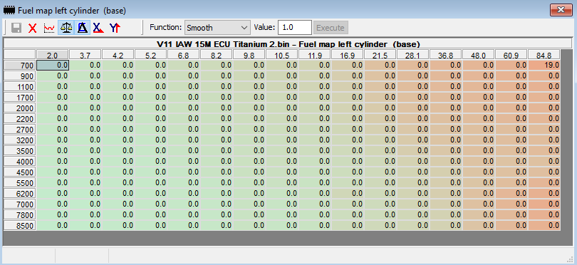

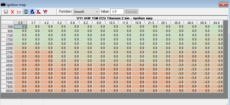

Lucky Phil Posted March 21, 2021 Posted March 21, 2021 1 hour ago, 80CX100 said: Nico Tks very much for the feedback on the Ti ECU, it sounds like a very positive effect on the running of your bike. The question I have for you or anybody else that may know the answer; I have a few different maps on hand saved on my computers, I'm sure one of them is a copy of the OEM Ti racing ECU map, if I load that map onto my 15M ECU in my Lemans, should I expect to see the same positive results that Nico has? Tia As a starting point I just checked the fuel, offset and ignition maps of the Ti map against the V11 Sport map and the only difference between a "Titanium" map and a std v11 Sport map is ignition advance at the top end at larger throttle openings. So from 36.8 to 84.8 (full throttle) there is between 3 and 5 degrees extra ignition advance on the Ti map. That's it. It was a similar thing with Ducati, I would never pay the extra money for the Ducati "special" ecus and just buy the pipes without the ecu as it was never worth the extra silly money they charged for them and had no practical effect on engine performance with a Ducati. Those ecu's just added 3% fuel everywhere and you paid around 1500 dollars for them. Ciao 1

NicoNZ Posted March 22, 2021 Posted March 22, 2021 4 hours ago, Lucky Phil said: As a starting point I just checked the fuel, offset and ignition maps of the Ti map against the V11 Sport map and the only difference between a "Titanium" map and a std v11 Sport map is ignition advance at the top end at larger throttle openings. So from 36.8 to 84.8 (full throttle) there is between 3 and 5 degrees extra ignition advance on the Ti map. That's it. It was a similar thing with Ducati, I would never pay the extra money for the Ducati "special" ecus and just buy the pipes without the ecu as it was never worth the extra silly money they charged for them and had no practical effect on engine performance with a Ducati. Those ecu's just added 3% fuel everywhere and you paid around 1500 dollars for them. Ciao Hi Phil, I here what you are saying. How does that explain the elimination of the cough or stumble on a constant throttle at around 2500 - 3000 RPM? That would be nowhere near the throttle openings you have referenced. Also the bike is a lot more responsive across the rev range. Its quite noticeable. I did have the RC ECU with the Lambda turned off through Tuner Pro. The only other contributing factor could be that a previous owner paid a guy a lot of money to @#$$#! around with the ECU to try and remove the stumble to no avail. Maybe he caused some of the poor running with other changes but as I understand it most standard maps cause the constant throttle stumble. I tell you its night and day. Couldn't believe it. Biggest grin inside a helmet for a long time.....

Lucky Phil Posted March 22, 2021 Posted March 22, 2021 57 minutes ago, NicoNZ said: Hi Phil, I here what you are saying. How does that explain the elimination of the cough or stumble on a constant throttle at around 2500 - 3000 RPM? That would be nowhere near the throttle openings you have referenced. Also the bike is a lot more responsive across the rev range. Its quite noticeable. I did have the RC ECU with the Lambda turned off through Tuner Pro. The only other contributing factor could be that a previous owner paid a guy a lot of money to @#$$#! around with the ECU to try and remove the stumble to no avail. Maybe he caused some of the poor running with other changes but as I understand it most standard maps cause the constant throttle stumble. I tell you its night and day. Couldn't believe it. Biggest grin inside a helmet for a long time..... Probably because the stumble is dependant on a few different parameters working together and unless they are it doesn't do it. So when my V11 was standard it used to have the stumble at times. When I changed to gear driven cam I went out and tried my best on several different rides to reproduce it to no avail and I reported here that it looked like the theory it was caused by cam chain slack might be correct. A ride or two later it was back again which I reported here. So a combination of rpm, oat, engine temp throttle position and baro pressure all influence the fuel injector duty cycle hence the fuel mixture and the ignition timing. Somewhere it seems when the combination of all or a few of these is aligned you get the stumble. So in my case I couldn't get it to stumble but then, different oat/engine temp and condition it's back. I think it's unlikely the Ti ecu fixes it or that would have been figured out 20 years ago. The fuel and ignition maps don't lie that's for sure. So here are the Delta fuel and ignition maps for a std 2000 V11 Sport and the Titanium ecu map. The delta map is a comparison map between the 2 maps you have loaded in Tunerpro to look at not the raw data but the difference between the two. The minus figures here indicate the original map being compared to is a lesser value than the comparison map which in this case is the Ti map as can be seen in the header. The all zero's indicates the maps are identical, no differences. The stumble is always down at very low throttle openings and usually around 2800-3200 rpm. Could also be a combination of the above AND the TPS and airscrew and TB balance factored in as well. Ciao 1 1
NicoNZ Posted March 22, 2021 Posted March 22, 2021 15 hours ago, Lucky Phil said: Probably because the stumble is dependant on a few different parameters working together and unless they are it doesn't do it. So when my V11 was standard it used to have the stumble at times. When I changed to gear driven cam I went out and tried my best on several different rides to reproduce it to no avail and I reported here that it looked like the theory it was caused by cam chain slack might be correct. A ride or two later it was back again which I reported here. So a combination of rpm, oat, engine temp throttle position and baro pressure all influence the fuel injector duty cycle hence the fuel mixture and the ignition timing. Somewhere it seems when the combination of all or a few of these is aligned you get the stumble. So in my case I couldn't get it to stumble but then, different oat/engine temp and condition it's back. I think it's unlikely the Ti ecu fixes it or that would have been figured out 20 years ago. The fuel and ignition maps don't lie that's for sure. So here are the Delta fuel and ignition maps for a std 2000 V11 Sport and the Titanium ecu map. The delta map is a comparison map between the 2 maps you have loaded in Tunerpro to look at not the raw data but the difference between the two. The minus figures here indicate the original map being compared to is a lesser value than the comparison map which in this case is the Ti map as can be seen in the header. The all zero's indicates the maps are identical, no differences. The stumble is always down at very low throttle openings and usually around 2800-3200 rpm. Could also be a combination of the above AND the TPS and airscrew and TB balance factored in as well. Ciao Thanks for that and yes the graphs do not lie although mine stumbled ALL the time at the 2800-3000 rpm range once up to temperature. Going through the decent tune up thread somewhat reduced it but it was still there all the time. The only change was the ECU and it has gone completely. I see another thread here where someone reported the same symptoms and once the TI ECU was swapped out the stumble was completely gone. The only change made. Also at 3000 rpm in 6th, on a downhill it would stumble due to no load on the motor as in constant throttle. Now completely gone. The other difference is driveability. By that I mean on / off throttle smoothness. Its a joy to ride now from the improvement in that area. Gear changes are a lot smoother because of this improvement. I did have a link to Meinhoff's latest map and actually downloaded it. Its been a year and cannot be sure which map it is so looking to find that map to try for a comparison. The file name of the one I have is 2017.08.31_#93_6.bin I wonder if this is a Meinhof map.
