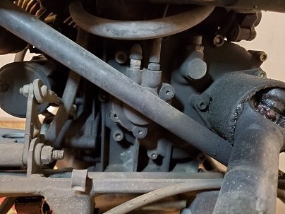

leroysch Posted January 29, 2022 Posted January 29, 2022 Had noticed accumulated grime about the timing sensor, so........... Three 0.6mm shims and an O-ring which had acquired and retained a square profile. Note to self: If you don't see an O-ring or land once the sensor is removed, ensure you have all the shims off the motor. 1
docc Posted January 29, 2022 Posted January 29, 2022 12 minutes ago, leroysch said: Had noticed accumulated grime about the timing sensor, so........... Three 0.6mm shims and an O-ring which had acquired and retained a square profile. Note to self: If you don't see an O-ring or land once the sensor is removed, ensure you have all the shims off the motor. Welldone, Sir! My notes say "#112 Viton" for that O-ring . . . 1
leroysch Posted January 29, 2022 Posted January 29, 2022 ..and your notes (which I used, referenced somewhere else on this forum...TY) are exactly right! Reinstalled with new O-ring, reused shims, and fired her up uneventfully. Need to get the oil viscosity down before I'll render a final verdict. 1
Lucky Phil Posted January 29, 2022 Posted January 29, 2022 3 hours ago, leroysch said: Had noticed accumulated grime about the timing sensor, so........... Three 0.6mm shims and an O-ring which had acquired and retained a square profile. Note to self: If you don't see an O-ring or land once the sensor is removed, ensure you have all the shims off the motor. I'd check that myself, 1.8mm of shims seems too much to me. Ciao 1
Tinus89 Posted February 1, 2022 Posted February 1, 2022 On 1/29/2022 at 2:01 AM, docc said: My notes say "#112 Viton" for that O-ring . . . That "Viton" addition is very important in my experience. A PO of my bike installed a non-oil-compatible o-ring there, which had swollen so much it pushed the sensor far enough off the phonic wheel to not make the engine run properly >3k rpm anymore. Took me ages to find the cause... 3 1

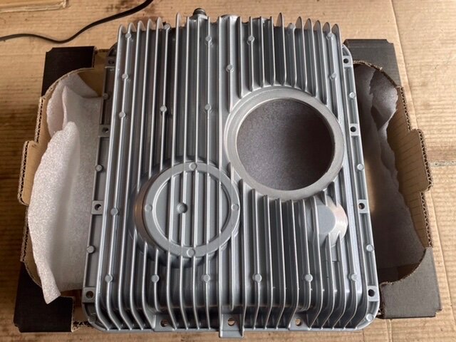

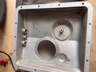

Guzzimax Posted February 4, 2022 Posted February 4, 2022 Newly powder coated sump, I’ve throughly cleaned inside removing all the sludge,ready to go back on the bike now the roper plate is installed 3

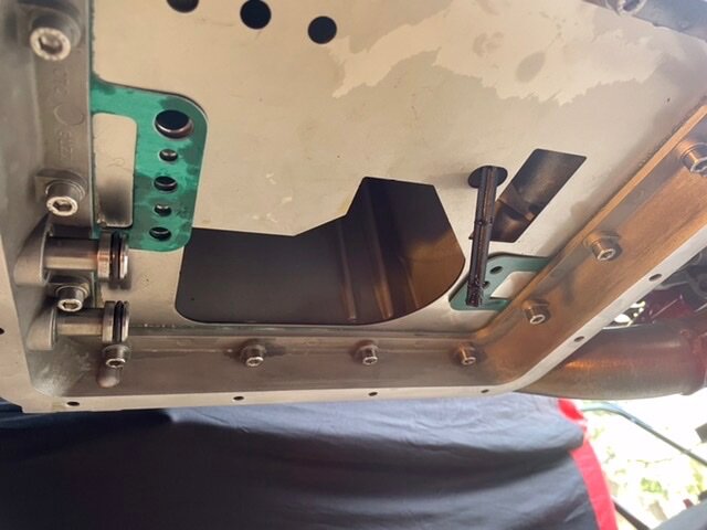

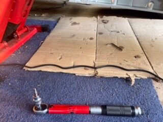

Guzzimax Posted February 4, 2022 Posted February 4, 2022 Roper plate installed, now to mount the oil filter carrier assembly. My small torque wrench is useful for correctly torquing the M6 bolts

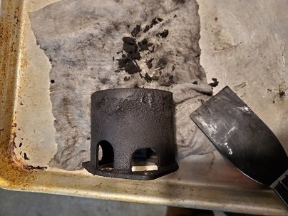

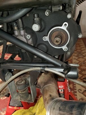

FreyZI Posted February 5, 2022 Posted February 5, 2022 Before and after pics: U-joint greased and reinstalled with cover. I had to scrape off the grime with a plastic putty knife. 3
billgreenman1 Posted February 5, 2022 Posted February 5, 2022 Ooh I want one of those small torque wrenches!
Guzzimax Posted February 5, 2022 Posted February 5, 2022 9 hours ago, billgreenman1 said: Ooh I want one of those small torque wrenches! Teng Tools 5 ~ 25 Nm 3/8th” drive. Mid range price & quality. You can spend a great deal on torque wrenches, (as with hand tools generally) and you tend to get what you pay for. The very cheap stuff is useless, might just as well use a normal hex drive and guess Have a 5 ~ 25 Nm, a 20 ~ 100 Nm, & 40 ~ 200 Nm 1/2” drive, which cover all I’ll ever need 1
Chuck Posted February 6, 2022 Posted February 6, 2022 I have several, from inch lbs. to 200 ft. lbs. FWIW, Ed the Rocket Scientist (RIP) said NASA did a study and found the most repeatable torque was applied by the hand of a skilled mechanic. Don't shoot me, I'm just the messenger.. 3
