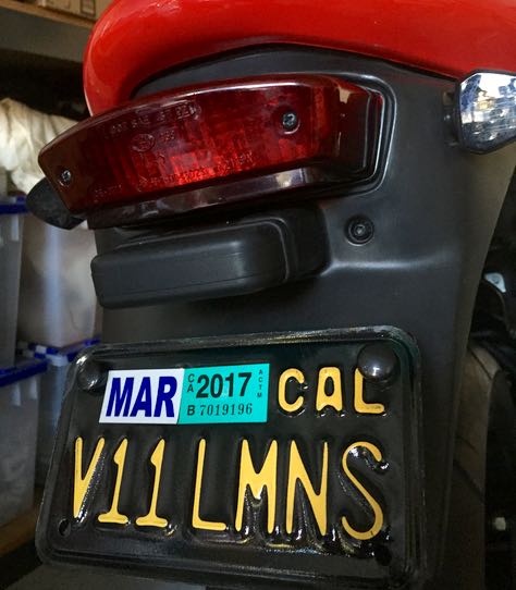

Antiquar Posted July 15, 2016 Posted July 15, 2016 Looking sharp! I didn't know DMV was releasing the classic black plates for bikes, too. Very cool.
Scud Posted July 15, 2016 Author Posted July 15, 2016 Only $40 - and you can do it all through your local AAA office if you are a member. Then $40 more per year on your renewal. I've been seeing a ton of the "legacy" black plates on cars down here - especially on black cars - but I've only seen a few other black plates on motorcycles. I liked the black plate on my Scura so much I had to get one for the LeMans.
