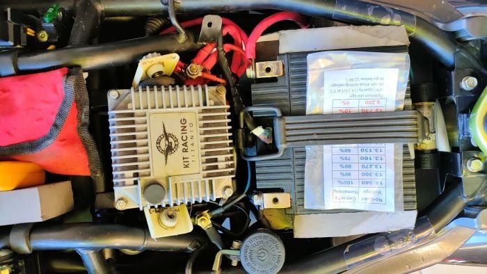

MartyNZ Posted February 19, 2022 Posted February 19, 2022 6 hours ago, stewgnu said: One particularly irritating point is having 4000 wires hooked up to the battery. I did the same as Tom; added terminal blocks. A jumper goes to each battery terminal, so there are only 2 connections to each battery terminal. 5

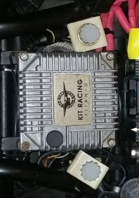

docc Posted February 19, 2022 Posted February 19, 2022 That hot positive is notably close to the grounded ECU case. One must be mindful swinging a spanner there . . .
MartyNZ Posted February 19, 2022 Posted February 19, 2022 17 minutes ago, docc said: That hot positive is notably close to the grounded ECU case. One must be mindful swinging a spanner there . . . True. Well spotted. Although normally those little screw-on covers are fitted to protect against shorts. Then I always follow the golden rule: " disconnect negative first, reconnect negative last" 5
stewgnu Posted February 20, 2022 Posted February 20, 2022 3 hours ago, docc said: That hot positive is notably close to the grounded ECU case. One must be mindful swinging a spanner there . . . oh gawd yeah- one further point is that my ace h/c fabbo relay is sited 1 inch from the + terminal… i reckon i’ll live with it a while yet, but them terminal blocks are the way forward for sure. My monza has 1 wire to the neg, and 2 wires to the pos hahaa! 1

p6x Posted February 21, 2022 Posted February 21, 2022 On 2/19/2022 at 4:13 PM, docc said: That hot positive is notably close to the grounded ECU case. One must be mindful swinging a spanner there . . . Even without the terminal extensions, the tow truck service that came to my rescue when the Guzzi got paralyzed proved that it is pretty easy to make some nice sparks trying to jump using for cars crocodile clamps. We had to finesse the connection to avoid more arc welding. I was actually wondering if anyone ever used vertical extensions to facilitate a jump start or even connecting a charger. Its pretty tight in there....
docc Posted February 21, 2022 Posted February 21, 2022 33 minutes ago, p6x said: Even without the terminal extensions, the tow truck service that came to my rescue when the Guzzi got paralyzed proved that it is pretty easy to make some nice sparks trying to jump using for cars crocodile clamps. We had to finesse the connection to avoid more arc welding. I was actually wondering if anyone ever used vertical extensions to facilitate a jump start or even connecting a charger. Its pretty tight in there.... I carry a dedicated set of "motorcycle jumper cables" in my pannier. The clips are sized appropriately for a motorcycle battery. Here is a set from AF1Racing/Yuasa. Be smart about your connection points and connection/disconnect sequence. I "isolate" my regulator when a jumpstart must be performed. YMMV. https://www.af1racing.com/Yuasa-8-Foot-MotorcycleScooter-Jumper-Cables 2

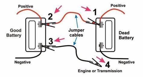

docc Posted February 21, 2022 Posted February 21, 2022 13 minutes ago, footgoose said: so std electrics.... pull the 30a fuse, jump, re-install fuse? Exactly. @MartyNZ knows best : "Then I always follow the golden rule: " disconnect negative first, reconnect negative last" Remember: positive to the batteries, negative (last connection to make, first to remove) to a remote grounding point on the jump vehicle (away from the compromised battery that may have out-gassed sensitive and explosive gasses.) Disconnect the negative from the jump vehicle first. (No spark near the compromised battery.) 1 1
MartyNZ Posted February 21, 2022 Posted February 21, 2022 5 hours ago, docc said: Remember: positive to the batteries, negative (last connection to make, first to remove) to a remote grounding point on the jump vehicle (away from the compromised battery that may have out-gassed sensitive and explosive gasses.) Disconnect the negative from the jump vehicle first. (No spark near the compromised battery.) I added pictures to illustrate the remote grounding point. Not only does this move sparks away from the battery and fuel system, but it also adds a tiny resistance to the circuit to avoid large currents buckling the discharged battery plates. However I'm not convinced that there is any need to isolate the regulator. See previous topic: https://www.v11lemans.com/forums/index.php?/topic/20617-charging-the-battery-hooked-up-in-the-bike-bad-idea/#elControls_236544_menu 3 1
docc Posted February 21, 2022 Posted February 21, 2022 Welldone, @MartyNZ! Agreed on the regulator isolation being unnecessary. It isn't worth loosening the fuse holder. No "arc welding" spark should occur with the method you have illustrated.
