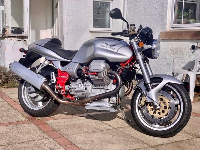

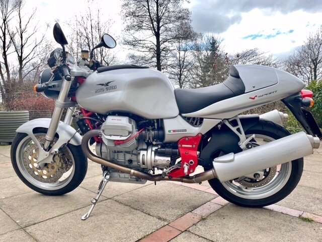

Guzzimax Posted March 5, 2022 Posted March 5, 2022 Took my silver Sport for its annual MOT test today (this is the annual UK roadworthy test, equivalent to the German TUV). First time out on 2 wheels since Nov last year. I generally get bikes back on the road towards the end of March when the road salt has gone 6
Kane Posted March 6, 2022 Posted March 6, 2022 Very nice collection of V11s, Guzzimax! Does each one serve a different riding purpose for you, or are you obsessed and just can’t help yourself? How about of a nice family pic or two? Your silver Sport looks fabulous. Cheers! 1
