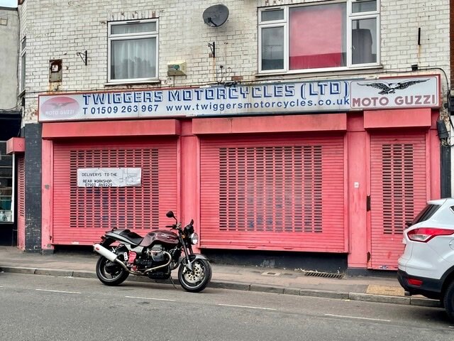

Guzzimax Posted May 21, 2022 Posted May 21, 2022 Throttle body balance today for the “grape ape” at Twiggers in Loughborough. Although they haven’t sold new Guzzi’s for several years, and the retail part of the business is now closed, their workshop is open for repairs & servicing. There aren’t many independent Guzzi specialists left in the UK, and I value being only 15 miles away 8

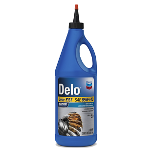

Pressureangle Posted May 24, 2022 Posted May 24, 2022 I've been waiting to fill my rear drive until my Chevron Delo Gear ESI 85w140 came in. Today was the day. First thing I noticed is that considering the labelled viscosity, it seems pretty loose in the container. Far sloshier than a heavy conventional gear oil. <wary look> Visually it's darkish golden, not much different than other lubes. No particular smell. I added ~255-260cc to my dry, clean gearbox. While hard to see through the fill hole, it's quite obviously far above the 'level plug' on the back of the box, and someone has probably figured out before that the level hole *might* be correct if it was horizontal to the ground with the axle. Turning the wheel, the oil appears thinner than the Redline heavy shockproof I had in it, as well as the Lucas/moly additive just lastly. But it also carries up the gear well and leaves a heavier coat than I expected. All my research says this should be as good as it gets, and has alien magical properties unknown to lesser oils. I'd say 'we'll see' about how well it works, but truth is there hasn't been any shortcoming in previous oils to compare to. <shrug> I feel good about it, which is about all we ever get to say about gear oils. 6 1
Pressureangle Posted May 25, 2022 Posted May 25, 2022 For what it's worth. I bought a case of 12. Subtotal: $96.78 USD Shipping: $32.00 USD FL STATE TAX - FLORIDA: $0.00 USD Grand Total: $128.78 USD
