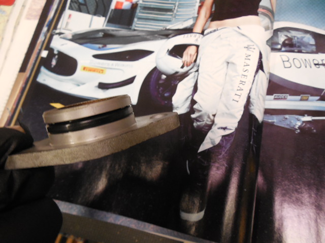

docc Posted June 15, 2022 Posted June 15, 2022 1 minute ago, Joe said: Docc, is the 1064 the same block as my 850? That's out of my pay-grade, bud. Here is an image of the susceptible O-ring on our V11 distributor blanking plate. Yeah, these can leak after a bit . . . 1 2
