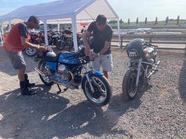

Pressureangle Posted July 21, 2022 Posted July 21, 2022 First ride after major maintenance. Brake light failed. Bulb not grounding. Fixed, then brake light stayed on constantly. Spacer behind handlebar switch missing. (there is a spacer there, right?) Found this too, drat it all. 1 3
Tomchri Posted July 21, 2022 Posted July 21, 2022 Still no luck finding that rubber protection for the rear master cyl . Seems it didn’t do much for Pressureangle though. Cheers Tom. 1
Pressureangle Posted July 21, 2022 Posted July 21, 2022 1 minute ago, Tomchri said: Still no luck finding that rubber protection for the rear master cyl . Seems it didn’t do much for Pressureangle though. Cheers Tom. Mine is split open at the top. I cleaned everything up and used liquid electrical tape to seal it. This will be a regular maintenance check at least with any tire or brake service. 3
