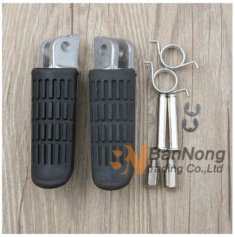

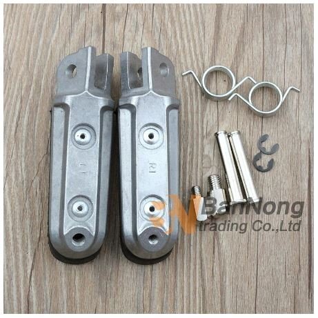

al_roethlisberger Posted February 22, 2023 Posted February 22, 2023 On 2/7/2023 at 12:37 PM, al_roethlisberger said: That's great to hear, and a really good deal. And yes I'm certain you are correct about where most are actually made As long as they don't break off when I stand on them, then that's OK. https://www.aliexpress.us/item/2251832622654235.html Well unfortunately these do not fit. I wonder if what they sent to you was a little different? The part number I ordered and received is XF-1081 The pins/holes are larger than the Guzzi/Ducati pins, so would need a bushing to install into the Guzzi V11 peg mounts. The Guzzi pins are 6mm and these are 8mm. They are nice pegs though, and much more squishy than the Ducati peg I bought. So I may look into a bushing like I had for the Buell drop pegs.

LaGrasta Posted February 23, 2023 Posted February 23, 2023 al_roethlisberger I mixed and matched OEM and Ali parts to fit these. I didn't have to modify anything though.
