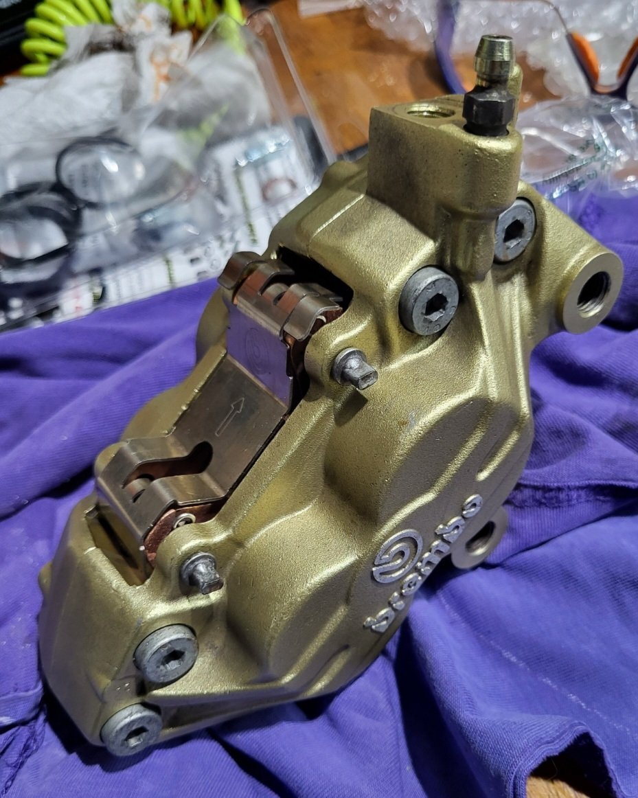

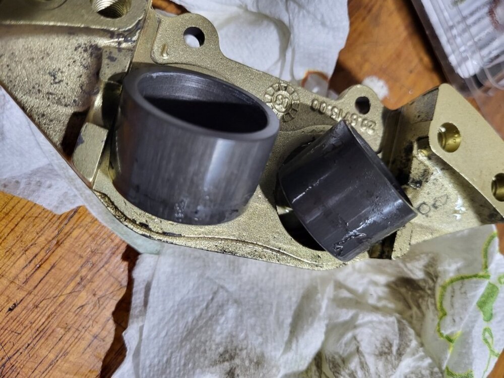

Martijn851 Posted May 11, 2023 Posted May 11, 2023 One caliper was fine, the other had a seized cup. Right finished, new seals and SBS pads. 5

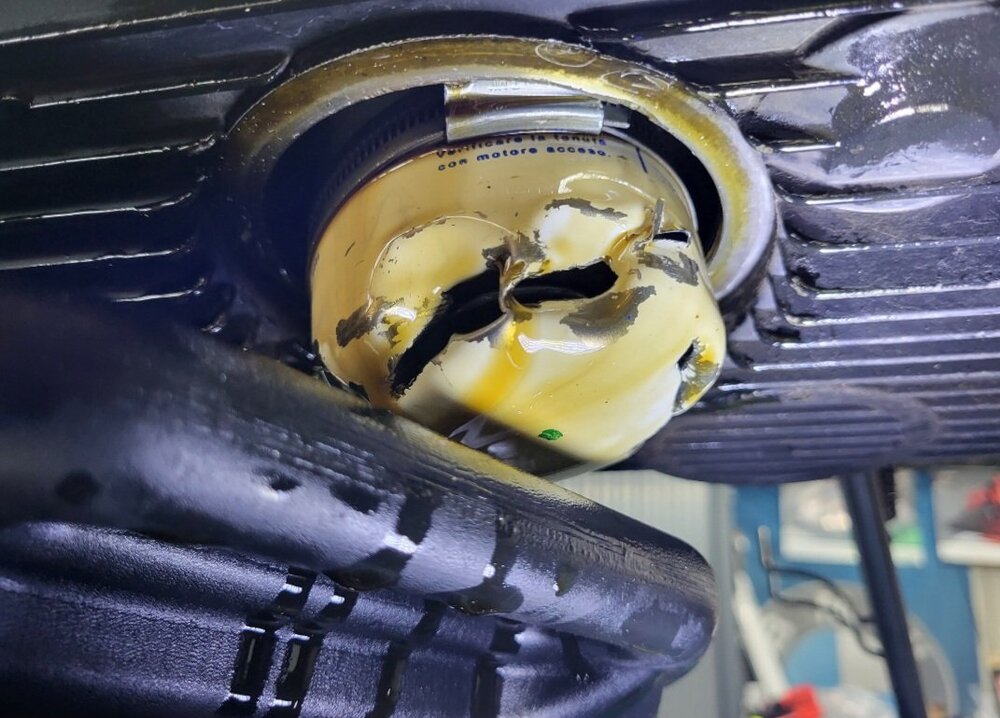

Martijn851 Posted May 12, 2023 Posted May 12, 2023 Is that fastener a practical joke for new Guzzi owners, or an upgrade to prvent the filter from loosening? A quick oil change turned into a pita and lots of oil every where.
docc Posted May 12, 2023 Posted May 12, 2023 43 minutes ago, Martijn851 said: Is that fastener a practical joke for new Guzzi owners, or an upgrade to prvent the filter from loosening? A quick oil change turned into a pita and lots of oil every where. There were reports of early filters coming loose with catastrophic outcomes. This could have been some faulty UFI gaskets, perhaps improper installation (the old "hand tight" oil filter DOES NOT apply to the V11). Some owners decided to add the hose clamp as a stop to prevent the filter loosening. Obviously, the sump then has to be removed to change the filter. Others of us followed some sage advice from testing carried out by member Ryland3210 and turn the filter one-and-one-eighth turns past gasket contact. Lots of us quit using UFI filters, as well . . Changing oil on a V11 I did not know, the owner marveled that I used a flashlight and a dental mirror to inspect for the possibility of a clamp on the filter . . . 1 1
Martijn851 Posted May 12, 2023 Posted May 12, 2023 I used a Hiflo, the oil wrench fits that one perfectly. 2
gstallons Posted May 12, 2023 Posted May 12, 2023 2 hours ago, Martijn851 said: Is that fastener a practical joke for new Guzzi owners, or an upgrade to prvent the filter from loosening? A quick oil change turned into a pita and lots of oil every where. Been there , done that ! 1
LowRyter Posted May 12, 2023 Posted May 12, 2023 Dropping the pan on these Guzzis gets old after a while. 3

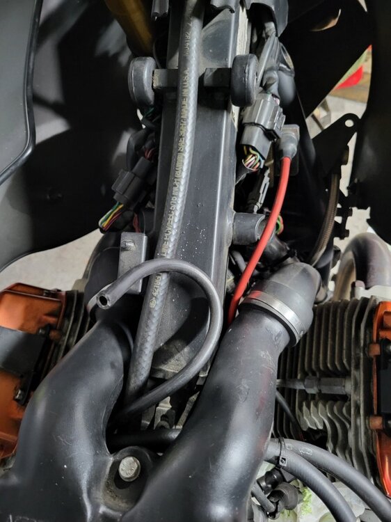

Martijn851 Posted May 15, 2023 Posted May 15, 2023 Aren't there supposed to be 2 lines coming from the tank, breather and overflow?
docc Posted May 15, 2023 Posted May 15, 2023 2 hours ago, Martijn851 said: Aren't there supposed to be 2 lines coming from the tank, breather and overflow? Correct. Two nipples under the tank. Seems like some regions the vent was left open to atmosphere? 1
MartyNZ Posted May 15, 2023 Posted May 15, 2023 2 hours ago, Martijn851 said: Aren't there supposed to be 2 lines coming from the tank, breather and overflow? Some people (including me) connect both nipples with a tee to a single drain line. 1 1
Martijn851 Posted May 15, 2023 Posted May 15, 2023 Thanks. I connected a short hose to a safe(r) location. Filter was due, but could be a lot worse. 1
