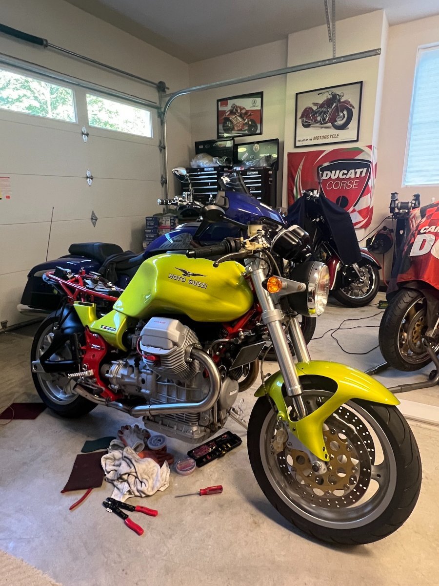

DucatiGuzziIndian Posted July 9, 2024 Posted July 9, 2024 Giving the Greenie a good clean, checking electrical stuff and polishing the exhaust before the new Mistrals go on. 4
guzzigary Posted July 9, 2024 Posted July 9, 2024 Looking good…. Pics please when the Mistrals are installed
