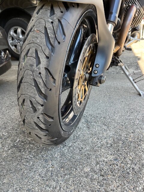

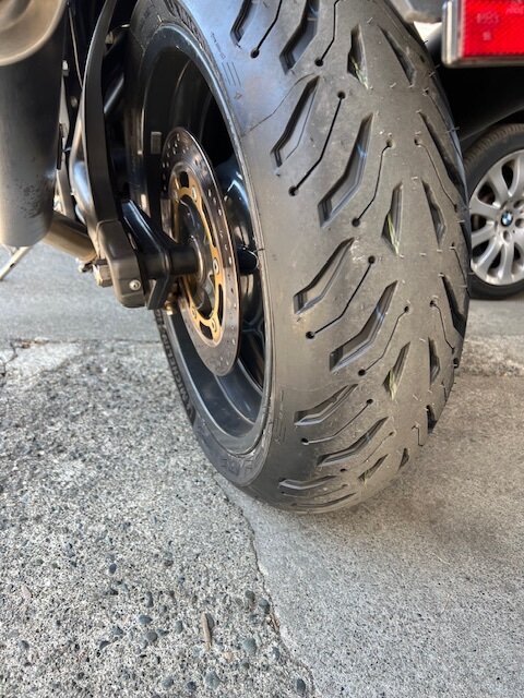

PhillipLarsen Posted July 22, 2024 Posted July 22, 2024 Replaced the standard size Michelin Pilot Power 2CT’s (Front had 12k Kms. (7200 miles) Rear 10k Kms (6200 miles) with Road 6’s 120/70ZR17 and 180/55ZR17. Have had it for a couple rides from Vancouver to Whistler return on Sea to Sky Hwy (sea level to 2200 ft) 150 miles round trip of nice twisty road. The 2CTs were finished, but I had really liked how sticky they were. The Road 6’s seem very nice handling, but comparing new to old is not really a fair evaluation. The Road 6’s are pricey compared to other option but wanted to try them to see how they do. 2
