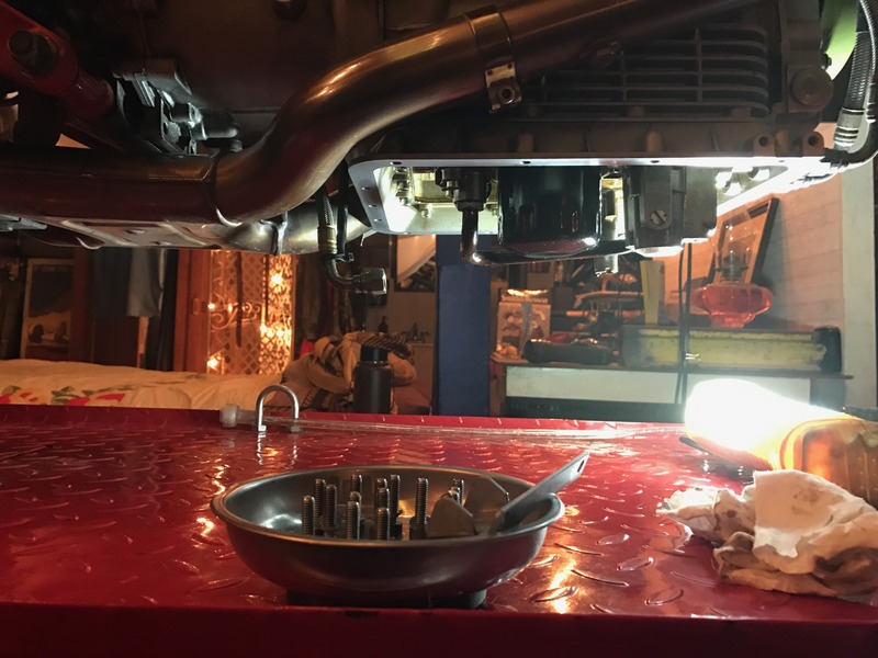

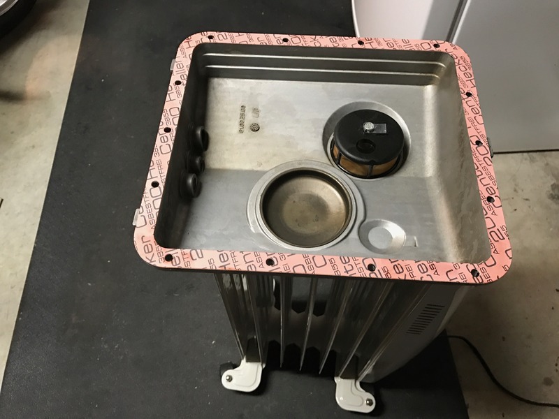

docc Posted December 24, 2016 Posted December 24, 2016 Just finished Step#4 on the "Decent Tune-up," conditioning the battery overnight and looking for a weather window tomorrow (Christmas Day) to warm the engine, finish the Tune-up and drop the oil. Time to replace that 100,000 mile sump gasket! Merry Christmas, ya'll! 1

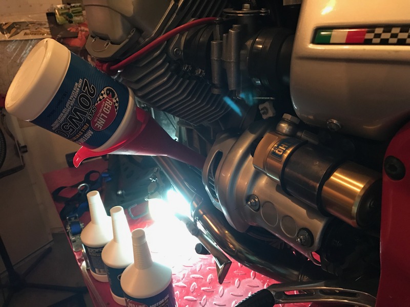

docc Posted December 26, 2016 Posted December 26, 2016 Thanks, gentlemen! It's a pleasure. I appreciate ya'll puttin' up with me (Heh, worked in another "ya'll" . . . . . . and even a * puttin' * ) Gave the Sport her Christmas presents today: 2

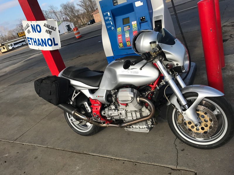

Scud Posted December 26, 2016 Author Posted December 26, 2016 WOW. She looks fabulous - factory-fresh even.
docc Posted December 26, 2016 Posted December 26, 2016 WOW. She looks fabulous - factory-fresh even. Complete with disappearing alternator cover!
