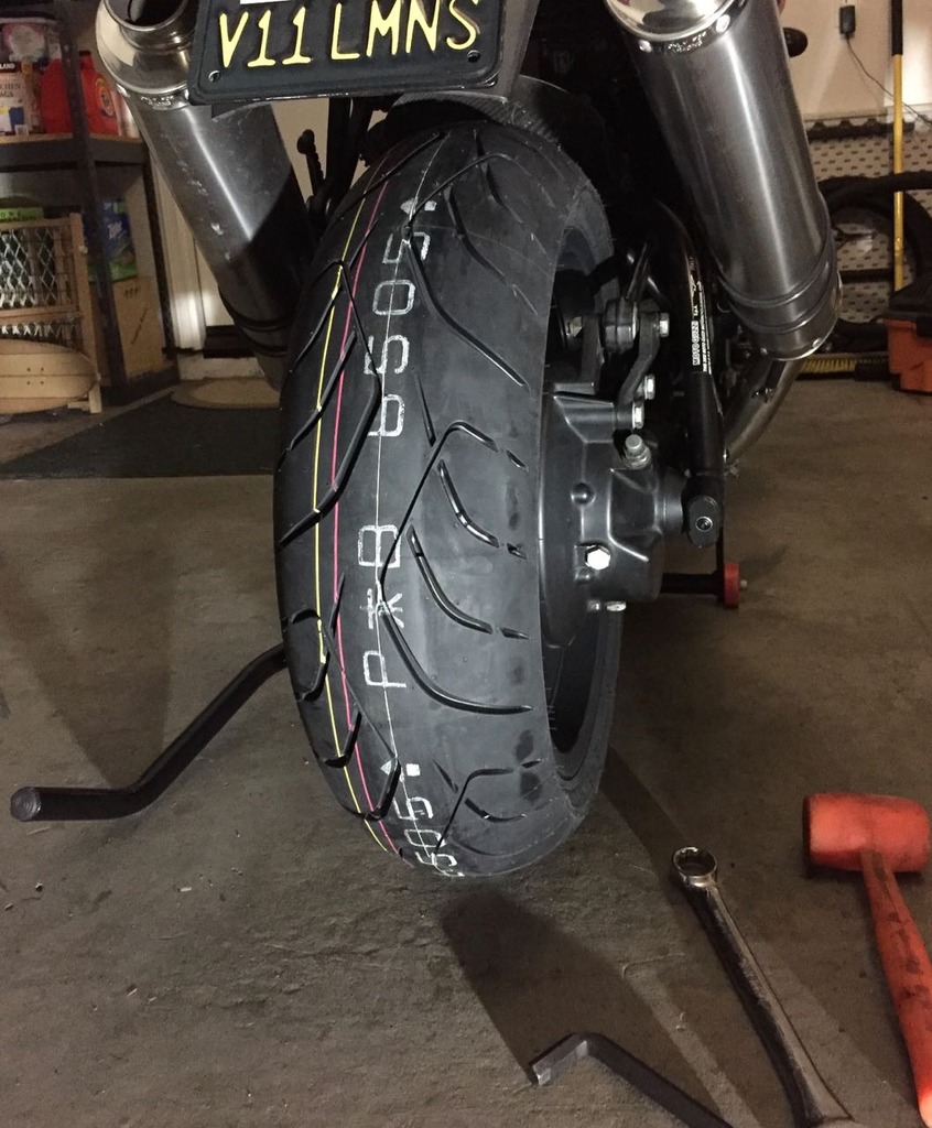

Scud Posted March 7, 2017 Author Posted March 7, 2017 Off with the old tires: Angel GT on front went 6,300 miles and the tread was flush to the wear bars - probably could have put a few more miles on it. Metzeler Sportec M3 went 3,300 miles - this new tire came "free" with my parts bike. It wore very quickly at the end, which I'm sure had nothing to do with my last ride... However, I won't use another of those on the V11. This "supersport" tire has a very thin sidewall - the benefit is that it came off the rim easily - but I think it's meant for lighter sportbikes. Installed an angled valve stem on the back (already had one on the front) Used my wheel balancer to find (and mark) the heavy spot on both rims. the back was 90-degrees away from the valve stem, and the front about 30 degrees away. Installed a pair of Dunlop Roadsmart 3s - lining the yellow dots up at the H marks resulted in very little weight being needed to balance the wheel. And Chuck - I took the top arm off the Harbor Freight tire changer - so much easier that way.

Scud Posted March 7, 2017 Author Posted March 7, 2017 the benefit is that it came off the rim easily - but I think it's meant for lighter sportbikes. That was the easiest tire to mount I've ever done. Now, I see what those guys at the bike shows that are hawking tire changers are using. They make it look so easy because it is. That M3 practically jumped off the rim - almost no effort required. But getting the new Dunlop Roadsmart 3 on the rim required nearly my entire vocabulary and constantly jamming the bead back down into the middle of the wheel. Dunlop is claiming to beat Michelin PR4's mileage - and it looks like a really good tire. Rode it to work today. Chuck - what do you use to hold the bead down and prevent it from creeping back up as you work around the tire? I just started using the Motion Pro Trail Bead Buddy that I carry in my dirt-bike tool kit. Works better than wedging a tire iron in - but I imagine that you have worked out a trick that I would like to know about...
Chuck Posted March 8, 2017 Posted March 8, 2017 Chuck - what do you use to hold the bead down and prevent it from creeping back up as you work around the tire? I just started using the Motion Pro Trail Bead Buddy that I carry in my dirt-bike tool kit. Works better than wedging a tire iron in - but I imagine that you have worked out a trick that I would like to know about... Uhh, on particularly onerous tires, I wrap a piece of leather on the rim and a 1 inch C clamp. That Dunlop probably qualifies. I doubt that you'll need air in it.
Scud Posted March 8, 2017 Author Posted March 8, 2017 Thanks Chuck. The Trail Bead Buddy (less than $10) is basically a tiny clamp - but it has a soft screw so you don't need to wrap it in leather. It worked a treat on my knobbies recently so I gave it a try on the street tires and it worked - although it did break through a section of the rim tape (sticker) on the front wheel. (BTW, I like Ru-Glyde for lubing the bead and the Mojo Lever.) And yeah, the Dunlop is sturdy. I think it took even more effort to install than the Pirelli Angel GT. And it made the crispest "two-pop" I've ever heard when the air pressure forced the bead up onto the rim. By contrast, I can fold the sidewall of the Metzeler M3 in one hand. All the Italian bikes have fresh tires now, and the German one can wait. There's some sort of political joke in there somewhere...
