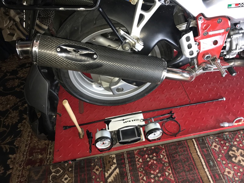

Progress on my ongoing Vitusectomy . . .
Copper hammer, no less . . .

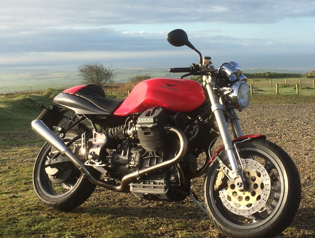

Well, its been a while since I posted here..... I built a house, aged several decades and shed loads of money. Brilliant! However, the Project survives and is just about complete.
As I retained the iaw15m ecu, the fuelling wasn't quite right, particularly at small throttle openings making urban use a bit of a pain. My original plan was to re-use a PCIII that used to live on my Centauro, but a trip to the dyno to get it set up revealed that it was u/s and kept crashing the computer whenever changes were attempted.
So Guzzidiag it is then. Today, the cables arrived from Lonelec and Guzzidiag, reader and writer were downloaded. A few hours reading the guzzidiag thread then connect up to the bike. A couple of headscratches to get the software to recognise the ecu and we are away!

Thanks guys, I should update the thread I started a few years back - before I got distracted by other activities and events. You guys deserve it, this forum is a great resource and has helped in a major way for me to build the Guzzi I really really wanted. A special thank you to the members who have provided parts - from all around the world! - and good technical advice. Hopefully I can pass on some of the lessons I learned along the way....
She's been a road legal rolling project for 3 years now, but the last 2 seasons were setting up; now she is just about right and I'm looking to doing some serious miles. At the dyno shop, we did manage a baseline run and with a couple of fuelling flatspots and just not getting enough at WOT, she was putting out 92bhp. I reckon theres a couple more ponies hidden away in there somewhere. When I've got to grips with Guzzidiag and sorted the fuelling I will get a printout  to post here. My first Guzzidiag excursion has been to follow docc's advice and zero the CO trim; took a ride today and i'm pleased to report a noticeable improvement in tractability in urban use. Thanks again docc!  Theres always the 1225 conversion if I want to get really carried away, but somehow I doubt it, I already have trouble finding the space for her to stretch her legs and she feels nicely balanced now. Having declared a finished build i fully intend to resist the temptation for more upgrades and just enjoy the machine. I'm not disappointed! :thumbsup:

Hey Scud, the forks are the stock White Power items off a Centauro. Yokes are from a 2000 V11 cos they have 4mm less offset, thus improving turn in. That did cause an issue with yokes striking the tank, but I will detail that elsewhere. Mudguard from Redmax Speedshop, an excellent builder and purveyor of quality performance bikes of style -  if you are in the southwest UK - stays self built.
