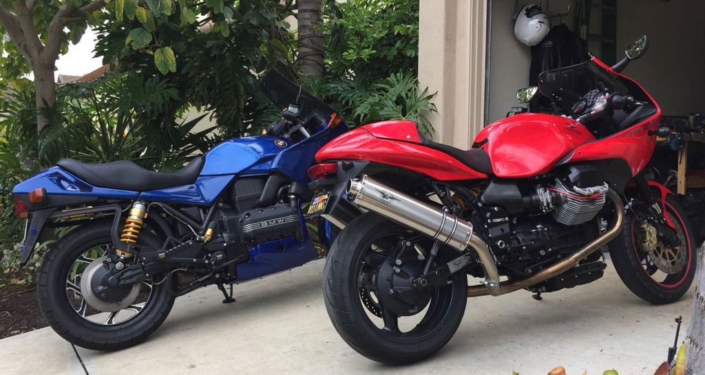

Scud Posted June 4, 2017 Author Share Posted June 4, 2017 Three vehicles due for service at the same time. Two bikes and my daughter's car. Her Toyota Highlander has over 150,000 miles on it and the used oil still comes out clean. That thing is amazing. Now onto the bikes... I was struck by similarities and differences in the K75s and the V11 LeMans. Sort of funny thing - both have Ohlins shocks from other bikes that I bought to fix-and-sell after removing the Ohlins. Final drives - the Guzzi fills through the top and has a special plug to determine the oil level. The Beemer fills through a hole is at the correct level - so if you measure the oil it comes up to exactly the threads in the fill-point (in other words - nearly impossible to overfill). Transmissions - oil changes were basically the same, but the Beemer runs straight into the pan, whereas the Guzzi has an exhaust crossover in the way. Engine oil - they both use a man-hole cover on the bottom of the oil pan. But the Beemer's cover has three tabs with three normal bolts (vs the Guzzi's fine threads on the edge of the spin-on cover). This was actually the first time I ever changed the Guzzi filter through the manhole cover (without dropping the sump). I found it interesting that they both orient the filter vertically - but I have never heard of anyone dropping a sump or using a hose clamp to secure the oil filter on the BMWs. Special note re UFI filters. Last time I did the oil my LeMans I used my last remaining UFI filter. When I removed it, the gasket stayed with the engine, instead of coming out with the filter. I had to reach in and remove it to prevent doubling up on oil filter gaskets. I'm using the WIX filters now - 1 1/4 turns past first contact. Plugs - they sure are easy access on the Guzzi - and they are way deep in the K75s, behind a metal cover and between the overhead (side-head?) cams. And they both got much-needed washes. The Beemer's tires are worn down the center. She gets most of the commuting miles and the long freeway runs... saving the tires on the Guzzis for the fun rides. Link to comment Share on other sites More sharing options...
czakky Posted June 5, 2017 Share Posted June 5, 2017 I like your style I try and service my machines all at the same time, if possible. Link to comment Share on other sites More sharing options...
Scud Posted June 5, 2017 Author Share Posted June 5, 2017 That was coincidental. The K75 was overdue. With four drivers in my house these days, the maintenance needs can pile up - and two more years till the youngest can drive. Glad my wife's Subaru has all maintenance included for a while longer. Link to comment Share on other sites More sharing options...
