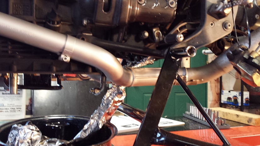

leroysch Posted December 29, 2017 Posted December 29, 2017 I've gone this season with these: https://realgaskets.com/product-category/motorcycle/moto-guzzi/ No leaks, but the recommended installation torques for the sump are pretty low. Had to buy a new torque wrench that I felt could do it reasonably accurately. Doing off season maintenance at the moment. We'll see how re-useable they in fact are!
leroysch Posted December 29, 2017 Posted December 29, 2017 Oh..and adding Al foil to shop inventory.....
LowRyter Posted December 29, 2017 Posted December 29, 2017 I've gone this season with these: https://realgaskets.com/product-category/motorcycle/moto-guzzi/ No leaks, but the recommended installation torques for the sump are pretty low. Had to buy a new torque wrench that I felt could do it reasonably accurately. Doing off season maintenance at the moment. We'll see how re-useable they in fact are! I bought three sets for the valve covers on the EV and the Sport. I think I have ruined three of them and am running one bike with one and one. I ordered some of those double thick paper gaskets, maybe I'll have better luck?
