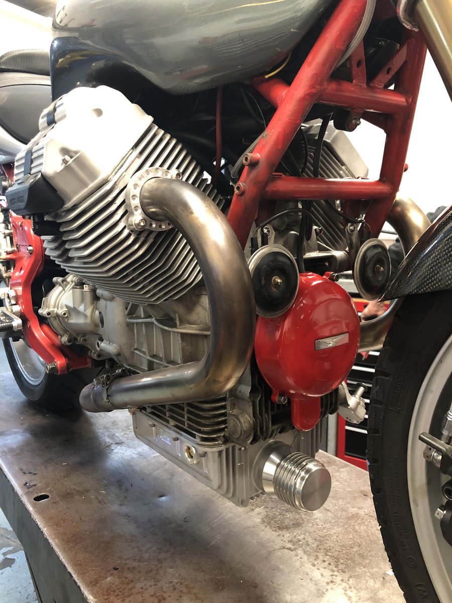

Installed the "Deep V" sump:
Used all Ti fasteners. Total weight savings is approx. 7.75 pounds (3.5 kg). Deleted the oil return line and put a one way flapper valve on the vent line.
Now that my front subframe is exposed, it quite obviously needs some loving!
  • Like 5
Also missing from that view is the regulator . . .
Why not put horns elsewhere and complete the "slipstream" look?
Great looks for sure. I like the valve covers and head guards, which ones are those? Maybe a different angle of ones I've seen before?? What is that kick stand? Running a slopper plate now/still?, seems like it may be more helpful with the extra oil. so.. how much oil capacity? Is that the oil filter protruding? Tokico caliper? GSXR front end?
Sorry, just so much in the pic. I like the naked sub frame looks too.
I *think* that oil filter is the stainless screen that you clean and reuse. :ph34r: If it is, I'd give it the flotation test. :oldgit:
13 hours ago, Chuck said:
I *think* that oil filter is the stainless screen that you clean and reuse. :ph34r:If it is, I'd give it the flotation test. :oldgit:
Does this mean you're not a fan Chuck? I'm not myself.
Ciao
I have a hard time thinking of anything good about reusing an oil filter.
I'm not sure about the micron rating of a steel wool pad in a filter housing .
I'm not sure what's inside that forward facing projection, but is there still the original canister filter inside the sump? Only that, now, there is no access cover and the sump has to be dropped to change the actual oil filter?
Sidestand attachment also had to be modified with no "sump spacer?"

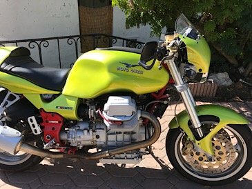

I was lucky enough to score a N.O.S. Guzzi/ Stucchi accessory windscreen in green. Bolted-on, no problem. She’s coming along!
  • Like 6
