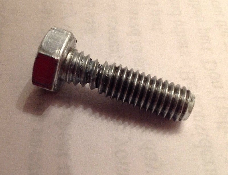

nobleswood Posted January 28, 2020 Posted January 28, 2020 Got lucky tonight; changing out the camchain tensioner ( yes I'm still tinkering with that ) as I torqued down the bolts the new, from the hardware store bolt 'gave' more than the other bolts & didn't make the wrench 'click' as quickly as the oem bolts. Could have been a disaster. 1 1
knumbnutz Posted January 28, 2020 Posted January 28, 2020 On 1/28/2020 at 1:00 AM, nobleswood said: Got lucky tonight; changing out the camchain tensioner ( yes I'm still tinkering with that ) as I torqued down the bolts the new, from the hardware store bolt 'gave' more than the other bolts & didn't make the wrench 'click' as quickly as the oem bolts. Could have been a disaster. Expand Special stretchy bolts. Did they charge you extra for these ? What did they say? Back it off half a turn...

Lucky Phil Posted January 28, 2020 Posted January 28, 2020 On 1/28/2020 at 1:00 AM, nobleswood said: Got lucky tonight; changing out the camchain tensioner ( yes I'm still tinkering with that ) as I torqued down the bolts the new, from the hardware store bolt 'gave' more than the other bolts & didn't make the wrench 'click' as quickly as the oem bolts. Could have been a disaster. Expand I'm betting it wasn't a grade 8 bolt. Ciao
docc Posted January 28, 2020 Posted January 28, 2020 Metric hardness 8.8 is not SAE "Grade 8" as I recall . . . 1
po18guy Posted January 28, 2020 Posted January 28, 2020 "Torque-to-yield" huh? I note here that Chinese 8.8 is often not "rest-of-the-world" grade 8.8 That bolt head looks rather industrial. As to snapped off bolt heads, once the torque is relieved, the shank will normally twist back out. Getting a purchase on it is the deal. A smaller bolt shank, even a wood dowel, some epoxy on the end, a little cure time and out they come. If they don't then the case threads are dirty (shame!), or were also about to let go. Found out back in the 70s at a garage where I worked when torquing a Cadillac rocker shaft bolt after replacing a head gasket. The threads were a good 8"-10" down the hole. It took a bit of patience and perseverance, but I got it back out.
Chuck Posted January 28, 2020 Posted January 28, 2020 So, what *was* the torque spec? Size of bolt? I *hate* stuff like this.. maybe counterfeit?
80CX100 Posted January 28, 2020 Posted January 28, 2020 On 1/28/2020 at 2:49 AM, docc said: Metric hardness 8.8 is not SAE "Grade 8" as I recall . . . Expand You're correct on that; I just stocked up on shear bolts for the snowblower on my new tractor, it's definitely a science. In SAE bolts 8 is at the top of the hardness spectrum and in metric bolts 8.8 is in the middle; but if the 8.8 metric bolt is of poorer quality it can snap off at a much lower force than expected. I copied over some info from one of the tractor forums below, fyi. The op was very lucky that bolt came out in one piece. Good luck with the next one Kelly "Your dealer does not understand metric hardware. Metric hardware does not come in grade 2, 5, or 8. The heads are stamped as 4, 7, 8.8, 10.9 or 12.something. Most Pronovost blower PTO shaft shearbolts are 10mm diameter 8.8 hardness which is your standard hardness for many, many metric hardware applications. The majority of metric bolts stocked at our dealership are 8.8 hardness."
