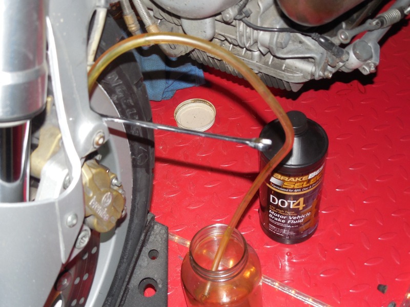

I am mounting a fresh Pirelli Angel to the front (the 18th front I've fitted!).
It is tempting just to remount the wheel, but I am following my *own* sage advice :oldgit: (also known as : good things I've learned from this forum!)  B)  , and am thoroughly cleaning and freeing the eight brake pistons. :luigi:

Seriously, ya'll: do this/ love your front Brembo Serie Oro:
Even though I had "just" worked the pistons and bled the front brakes 20 months/7500 miles ago, this procedure makes a remarkable difference in braking and feel. :thumbsup:

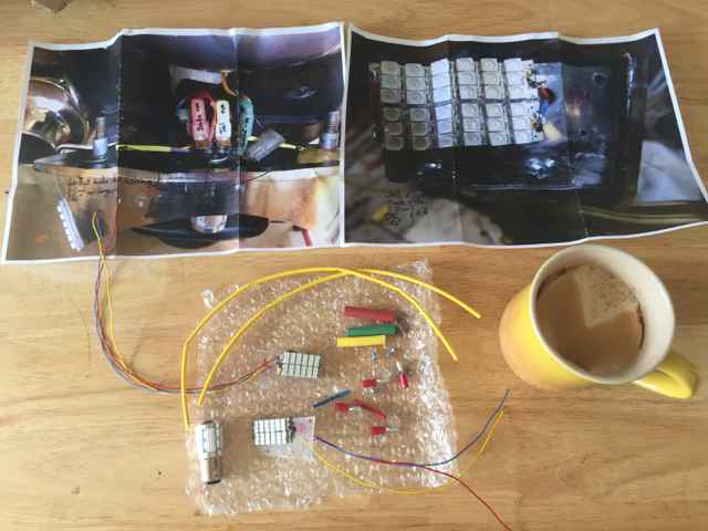

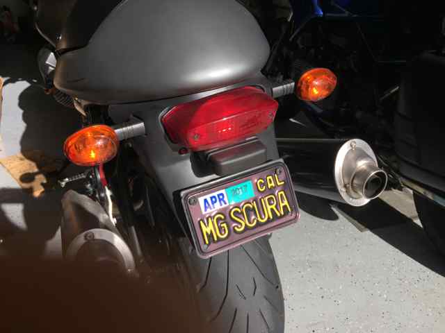

I installed MartyNZ's LED taillight kit, along with a pair of LED turn signals I've been "storing" for a while. FYI - if you put LED indicators in back, but leave incandescent indicators up front, they will work with the stock flasher.
Before:
Step one, coffee, unpack the kit, and review Marty's instructions:

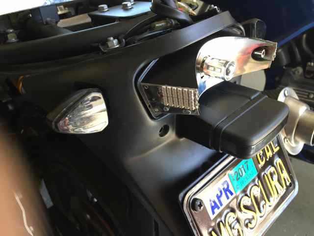

The clever, and practically invisible mounting of the side running lights and "bonus" tail and brake lights:
And yes, I painted the non-reflective portions of the chrome light base black.
After:
Lit up - far brighter than stock - even with the newly tinted lens.
@Marty - this is great kit. Everything included and not difficult to install. I did not need to get anything extra to install it - and it worked the first time.  :notworthy:  :bier:
