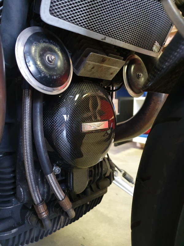

Tinus89 Posted February 13, 2020 Posted February 13, 2020 On 2/12/2020 at 11:40 PM, Lucky Phil said: At that price I'd be interested to know if the mount points have aluminium inserts. Expand Nope, they don't. I could not find any who did, so I decided I'll try it anyway. I considered reeming the holes and making alu inserts myself, but did not dare to reem the holes. Good tip on rubber washer+locktight. I may just do so. On 2/13/2020 at 1:37 AM, LowRyter said: Where'd you get the alt cover? Expand https://mdicarbonfiber.com/ The finish quality is excellent, however I would like to have seen it a little bit thicker. And with Lucky Phil's alu inserts in the mounting holes.
Lucky Phil Posted February 13, 2020 Posted February 13, 2020 I must say the mounts look quite thick and robust depth wise anyway. Others I have seen have mounts about 2mm thick. Ciao
LowRyter Posted February 13, 2020 Posted February 13, 2020 I got the "last one" for $78. Should look great since the Greenie has the factory CF bikini fairing. BTW- does it replace the factory cover or attach over it?
footgoose Posted February 13, 2020 Posted February 13, 2020 On 2/10/2020 at 11:55 AM, Tinus89 said: Replaced the old & tired alternator guard with a flashy CFRE one. Old New Downside: now the oil cooler guard is ugly... Expand Did you get the plain or twill weave. at different places in the photo it resembles both
Lucky Phil Posted February 13, 2020 Posted February 13, 2020 On 2/13/2020 at 3:45 PM, LowRyter said: I got the "last one" for $78. Should look great since the Greenie has the factory CF bikini fairing. BTW- does it replace the factory cover or attach over it? Expand Replaces. Ciao
LowRyter Posted February 14, 2020 Posted February 14, 2020 On 2/13/2020 at 8:17 PM, Lucky Phil said: Replaces. Ciao Expand Tinus, Did you pull the little Guzzi emblem off the old one or pay small fortune for another? Phil, I'll look for some metal sleeves to reinforce the mounting tabs. You recommend aluminum? Just drill the CF and insert the sleeves? Glue them in or not?
Lucky Phil Posted February 14, 2020 Posted February 14, 2020 On 2/14/2020 at 12:58 AM, LowRyter said: Tinus, Did you pull the little Guzzi emblem off the old one or pay small fortune for another? Phil, I'll look for some metal sleeves to reinforce the mounting tabs. You recommend aluminum? Just drill the CF and insert the sleeves? Glue them in or not? Expand Well the wall thickness on the outside of the mount looks a bit thin for an insert but they are quite deep so thats good. Generally the item needs to be designed for the insert. I'd just flatten the mounting faces off on a plate if possible then screw it down without too much force with some blue loctite. When you bolt it down look to see if it tends to distort and load up the mounts too much. When this happens I usually use some small thin homemade rubber washers under the mounts and then torque up lightly with the loctite. Ciao 1
LowRyter Posted February 14, 2020 Posted February 14, 2020 Thanks Phil. Common sense advice that I am deficient.
Rox Lemans Posted February 15, 2020 Posted February 15, 2020 On 2/13/2020 at 7:15 AM, Tinus89 said: Nope, they don't. I could not find any who did, so I decided I'll try it anyway. I considered reeming the holes and making alu inserts myself, but did not dare to reem the holes. Good tip on rubber washer+locktight. I may just do so. https://mdicarbonfiber.com/ The finish quality is excellent, however I would like to have seen it a little bit thicker. And with Lucky Phil's alu inserts in the mounting holes. Expand Thanks. I just bought the last one. I have been looking for one of those for 3 years. 1

Tinus89 Posted February 17, 2020 Posted February 17, 2020 On 2/14/2020 at 12:58 AM, LowRyter said: Tinus, Did you pull the little Guzzi emblem off the old one or pay small fortune for another? Expand Yes, worked it off with a small screw driver. Worked remarkably well. On 2/14/2020 at 1:36 AM, Lucky Phil said: Well the wall thickness on the outside of the mount looks a bit thin for an insert but they are quite deep so thats good. Generally the item needs to be designed for the insert. I'd just flatten the mounting faces off on a plate if possible then screw it down without too much force with some blue loctite. When you bolt it down look to see if it tends to distort and load up the mounts too much. When this happens I usually use some small thin homemade rubber washers under the mounts and then torque up lightly with the loctite. Ciao Expand As the spacer behind the original cover is plastic as well, I and the new cover is CF, I think applying low torque (say 5-10Nm) and using Loctite should be sufficient. I'm not going to put inserts in there, not worth the risk. 1
docc Posted February 18, 2020 Posted February 18, 2020 I hope it is okay I added that image to Tinus89's last post. That is an excellent result! 1
