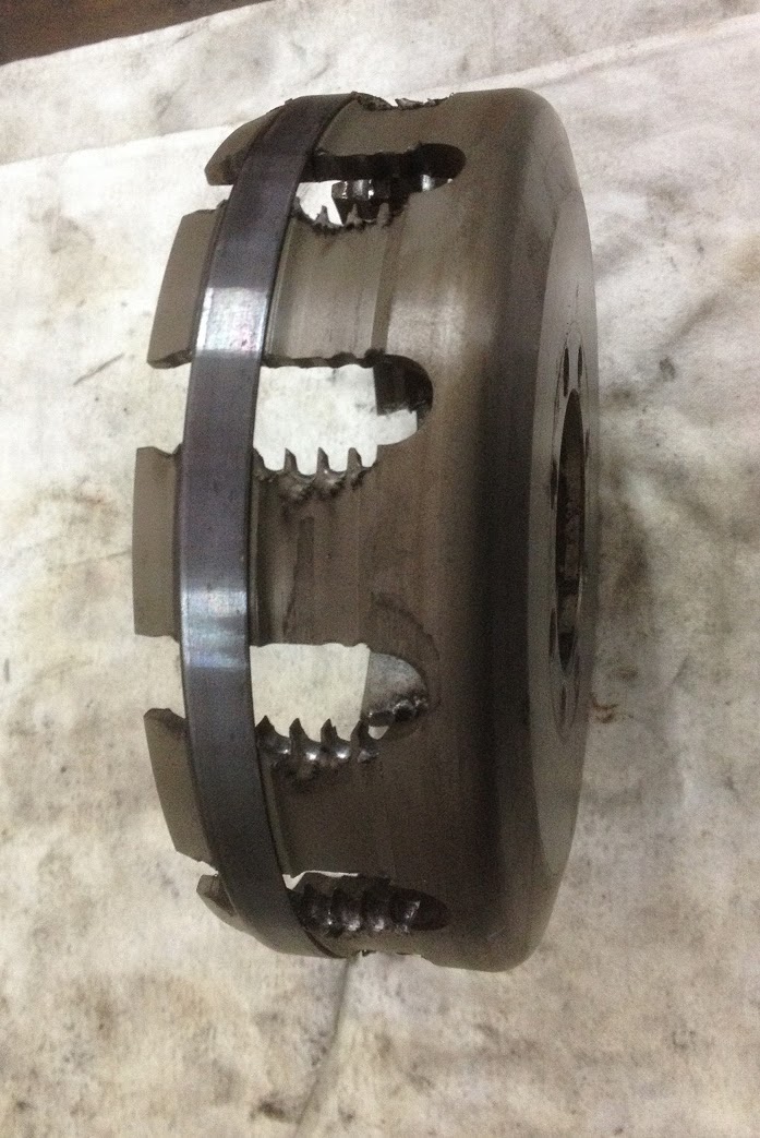

knumbnutz Posted April 15, 2020 Posted April 15, 2020 On 4/15/2020 at 11:04 PM, Chuck said: Think about how the clutch works. There are two clutch plates with an intermediate plate between them held together by a pressure plate and springs. All three are located in the flywheel by splines. The inner splines fit the transmission input shaft splines. Engaging the clutch frees the plates. They are free to rattle back and forth because of the uneven firing order of the Guzzi engine. Naturally, as they do this, you can hear them. What you don't want to do is leave the clutch "engaged" for any length of time because of this. Bump it into neutral and release the lever as much as possible. That will reduce wear of the flywheel, clutch splines, and transmission input splines. Expand Well I understand this, but more specifically, the ducati friction plates are steel and the clutch baskets are aluminium. The plates wear groves into the baskets thereby creating more and mor play for the plates to move in. Every 30K - 60K you would not just be replacing the plates, but the hub as well. Some aftermarket companies like barnett offer stainless steel baskets to offset the wear.
Lucky Phil Posted April 15, 2020 Posted April 15, 2020 On 4/15/2020 at 11:40 PM, knumbnutz said: Well I understand this, but more specifically, the ducati friction plates are steel and the clutch baskets are aluminium. The plates wear groves into the baskets thereby creating more and mor play for the plates to move in. Every 30K - 60K you would not just be replacing the plates, but the hub as well. Some aftermarket companies like barnett offer stainless steel baskets to offset the wear. Expand Not all Ducati baskets are aluminium most std ones are steel.Inner hubs are aluminium for the most part on a steel splined inner section separated by rubber cushions. The rattle principle is the same though just less splines of one sort or another to gangle around. Ciao
knumbnutz Posted April 15, 2020 Posted April 15, 2020 On 4/15/2020 at 11:32 PM, docc said: That is such superb explanation. What has always led me askew is the use of the term "engaged" (versus "disengaged"). Must agree with footgoose on this: "engaging" the control lever disengages the clutch (and twin plates with intermediate plate rattles and will beat hell out of the gearbox input hub). Lever out in neutral (or underway) and the clutch plates are all "engaged" with no rattle, no hub damage. Can we agree that the clutch, itself, is "engaged" when the lever is out and all of the clutch components are gathered together by the spring pressure? As highlighted above, I would suggest, "Pulling in the clutch lever disengages the clutch, itself." And this, Chuck, "Bump it into neutral and release the lever as much as possible. That will reduce wear of the flywheel, clutch splines, and transmission input splines." is true wisdom. For some of us, hard won . . . Expand Well, thats interesting.. Basically the same as a ducati clutch but in reverse.. I was thinking the rattle might come from the plate rivets or somewhere in that part, not the gearbox spline. There was no wear on mine here.
knumbnutz Posted April 15, 2020 Posted April 15, 2020 *Not mine but ducati basket rider was undoubted deaf 1 1

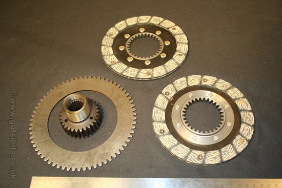

knumbnutz Posted April 16, 2020 Posted April 16, 2020 Is that the difference between standard and single plate?
Lucky Phil Posted April 16, 2020 Posted April 16, 2020 On 4/15/2020 at 11:52 PM, knumbnutz said: *Not mine but ducati basket rider was undoubted deaf Expand Yes,without doubt. Thats the worst I've ever seen, apart from the one that ripped all the fingers off the basket and scattered them to the 4 winds. Ciao 1 1
pete roper Posted April 16, 2020 Posted April 16, 2020 On 4/16/2020 at 12:14 AM, knumbnutz said: Is that the difference between standard and single plate? Expand Note that the Gutsibits kit uses Surflex friction plates which will eat the splines in the center of the plates in short order. To be avoided. Unsurprising they sell shonky shit given their history of thievery. The single platers use a single diaphragm spring for pressure and incorporate anti-rattle springs in the centre of the plate. That one looks like one from an 8V.
