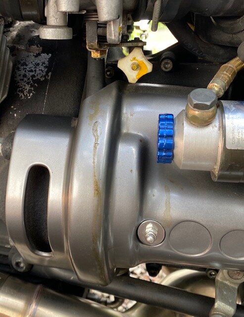

Gmc28 Posted June 15, 2020 Posted June 15, 2020 1 hour ago, docc said: On the No Crank, sounds like clutch switch bullet connectors on the left side of the frame. I have serviced those (clean, treat, crimp, seal) with the fairing and tank in place, but it’s fiddly. There is a link with image in the Tank Off Maintenance Checklist. You can also rotate the bars side to side while holding in the clutch and start button to see if it engages. thanks Docc. i should have thought of that. but as my wife says, just a kid trapped in a mans body... BTW, your 115k machine sure looks nice in the pics after your mx. Special diet, massaging, and skin care creams keeping her in good shape? I forgot to mention that i also noticed more of drip under the left throttle body, on the starter plastic cover. used to drip about once a month, but seems worse now, though its been mostly sitting for the last many months. may pull that left side TB and take a look.
