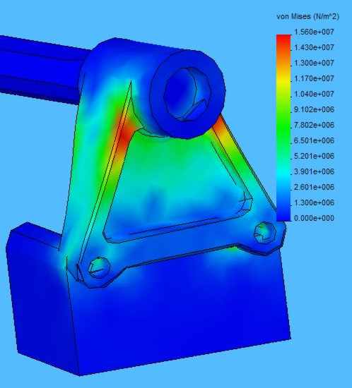

Paul Minnaert Posted January 28, 2004 Posted January 28, 2004 Al, I have ordered a PVM rearwheel, so with the new wheel, began the thinking about the rear brake. I don't use the brake, but it should be there, and working. The disk is only 190mm against the 280mm from the v11. That's real lightweight. It's a scooter front disk. Then after I decided on the disk, I went looking for a caliper, the stock one doen't fit here. So after looking at the posibilities, I bought a one size smaller version of the brembo, 30mm pistons instead 32mm. And designed a mounting thing for the caliper. And then Ebay came.... I had seen the PVM 4pot caliper already, but at 500+ euro way to expensive. But then it was on ebay, and now it's mine . It's new unused. It's milled out of one piece of billet. Beautifull made. I'm now designing a new mounting thing for it. And I can use a program that lets you apply forces on the piece, so you see where you can take off material, or have to make it thicker. Fun playing. But I wait until I get the wheel with (letting it) make it from billet. See attached picture what sort of output such a program gives.
