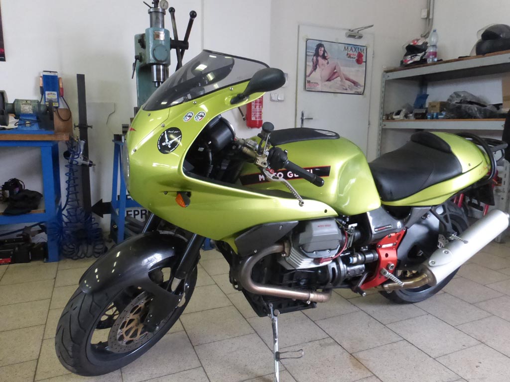

gelos Posted March 1, 2016 Posted March 1, 2016 It's make me very happy modify my V11 to be faster. Open airbox without lid, open exhaust mufflers, milled twin spark heads with stock piston, Stucchi cross-over and many work on personaly ECU remapping via TunerPro + GuzziDiag/Reader/Writer.
footgoose Posted March 1, 2016 Posted March 1, 2016 It's make me very happy modify my V11 to be faster. Open airbox without lid, open exhaust mufflers, milled twin spark heads with stock piston, Stucchi cross-over and many work on personaly ECU remapping via TunerPro + GuzziDiag/Reader/Writer. please gelos, let's see some photos! 2
