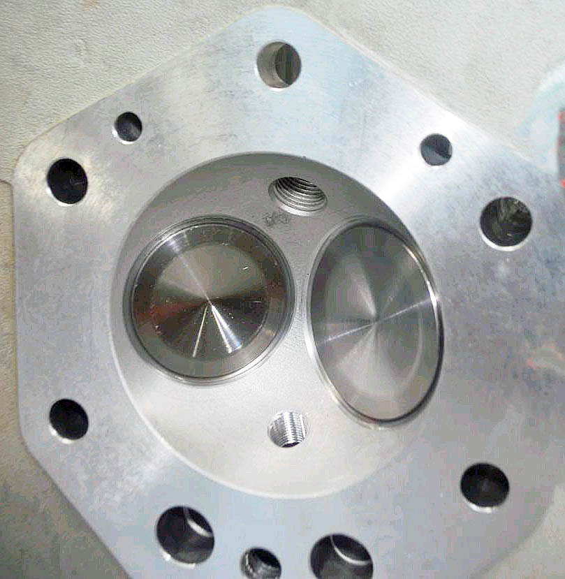

motoguzznix Posted March 2, 2016 Posted March 2, 2016 Hi knumbnutz Here is my advice: 11:1 is too much CR for a V11 engine, even with twin spark ignition. Don't bother with those pistons. The stock ones are strong items. Raise the pistons in the bores by milling the cylinders on bottom gasket surface. They should be flat with the head gasket surface. Squish is then given by the head gasket thickness - get the stock ones with 1,2 mm. After market gaskets can measure 1,5 - 1,7 mm which cost CR! You can mill the head for more CR, but don't go above 10:1 with single spark ignition. Your stock V11 flywheel is already as light as your lightened Mille GTs was. Small gains are still available by machining it. Stucchi crossover is fine, small gains are avilable. Mistral crossover is a disaster and costs a lot of HP at top above 6000rpm. Mistral cans do not cost HP but gains were not noticed when I measured it on the dyno. The camshaft is good, just check timing - best ist slightly advanced at 104/108° inlet/exhaust max lobe. My own V11 was retarded. The heads should undergo a service. The valves wear out at the shafts very early - go for better ones and replace the guides at the same time if necessary. Big gains are available from remapping the ECU. Fuel and ignition maps need rework. When you do your own Lambda measurements, it can all be done by yourself. Gelos went that route with very good success. Just use Tunerpro and Guzzidiag which are avialable for free / a donation. This was a quick guide with low budget mods if done by yourself. There is no expansive aftermarket hardware necessary to make the V11 go faster. Enjoy it! 2
Camn Posted March 2, 2016 Posted March 2, 2016 don't go above 10:1 with single spark ignition A twin spark head done by HTMoto in Germany. Don't know how much higher the CR is, but this is the thing to do if you want to change the cahracter of a V11 to a more hurried one (specially at 5000-8000 rpm).
