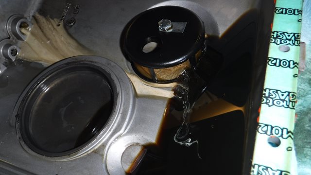

HRC_V4 Posted July 5, 2016 Author Posted July 5, 2016 This oil came from the rear oil line while I was installing the Roper plate, looks like the coolant milkshake when a head gasket fails, but this thing is air cooled. Any thoughts? Another question, I put a full gallon of oil (4qrts) and it looks like I could add a little more, does that sound about right?
czakky Posted July 5, 2016 Posted July 5, 2016 A little moisture was in the oil. It was probably old? Are you using the threaded or un- dipstick method? I thread and put in about 3.75qts. Anymore and she just uses it to about 3.75, that's my method.
docc Posted July 5, 2016 Posted July 5, 2016 That rear oil line is the return from the crankcase vent that makes its was through the spine frame's backbone. No surprise for it to ahve picked up some moisture over time. With the tank off, you can loose it at the upper end and give it a good flush out.
HRC_V4 Posted July 6, 2016 Author Posted July 6, 2016 A little moisture was in the oil. It was probably old? Are you using the threaded or un- dipstick method? I thread and put in about 3.75qts. Anymore and she just uses it to about 3.75, that's my method. When I put the Roper plate on, I marked the new dipstick 2 cm below the plate, and I am a little below that with 4 quarts, but I did spill a little, so maybe 3.9 quarts. OK, I think this sat a while, so moisture makes sense. I won't worry about it then.
moto fugazzi Posted July 6, 2016 Posted July 6, 2016 The moisture also happens from short trips whereas the oil doesn't get hot enough to burn off the moisture. Condensation also collects in the engine with the heat and cold difference of the engine vs. cool weather. Quite similar to old single pain windows in wintertime, where condensation would build on windows when it's cold outside and hot inside. Looks like you need to go for a long ride this weekend, and burn all of that off. Ken 2
