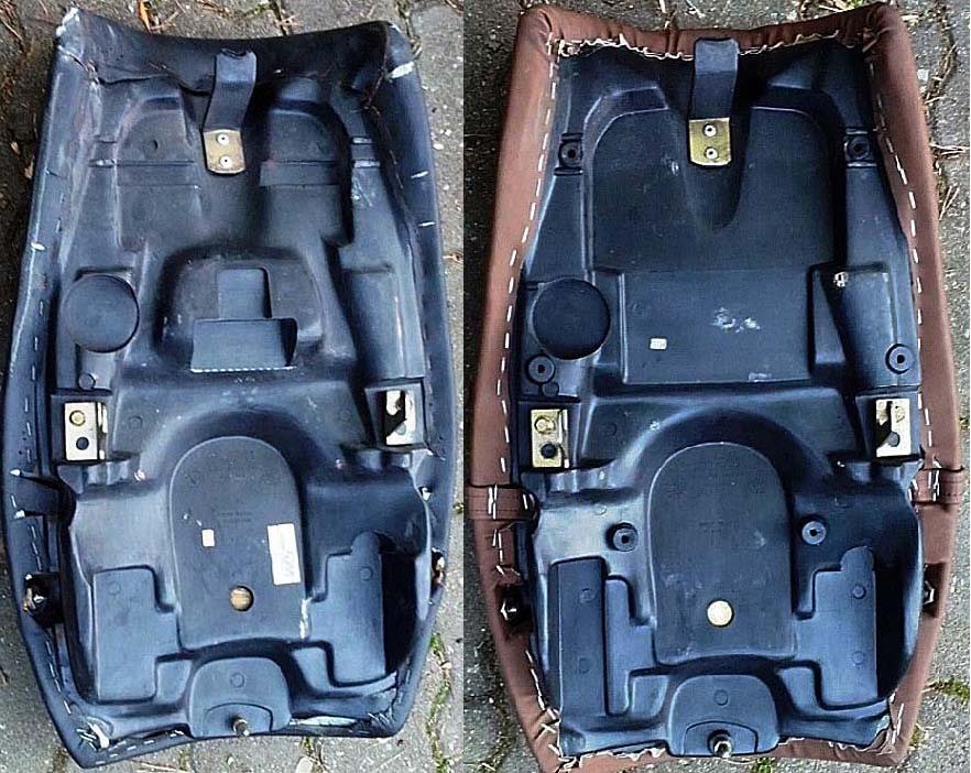

Bad news for me - but maybe good news for somebody else... The Corbin doesn't fit.
There are at least two points preventing the seat from closing, and I suspect that if I relieve those, that some others will reveal themselves.
Two bump stops can be easily removed by drilling out rivets, but clearing the relays would take quite a deep gouge.
It's otherwise a very nice seat, although the green corner is worn through on the edge. The red part of the seat cover is not the same hue as my LeMans' bodywork - and I am fussy about matching colors...
So, rather than cut the pan and recover the "flag" portion, I'm inclined to move this along to somebody with a red-frame sport. It would look fabulous on a silver, black, or grey tailpiece. Send me a PM if you're interested.

So this got me doubting the fit of my Corbin. The photo of yours seems to match my seat. I put my seat on the 02 LM and it fit as well as one could expect for aftermarket. I had to imprint on something for a contact test. I used corrugated cardboard about 3/32". There was a small but definite hit on the front corner of the relay. And a slight corner hit on the fuse box. I'm sure I could hammer a dent to clear both. The rubber bumpers seem to be in the correct spot, but I can't really tell. The seat is a good fit otherwise.
Now, strangely enough, it doesn't fit as good on the Tenni. I didn't pursue the reason cause I don't care :) Could be the rear catch position.  Sorry about your seat, hope I didn't mislead.
