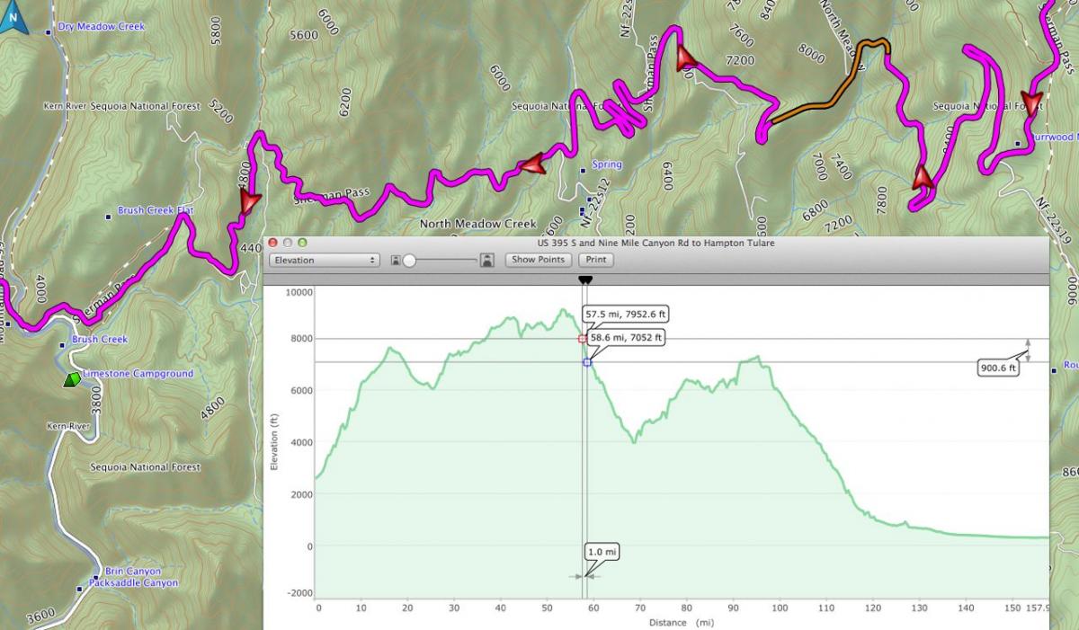

To Andy's earlier point about regarding mountain riding, I do worry about overheating my front brakes in the mountains, and it's not just the grade of the road. For example, the orange section in the attached image represents a 900 foot descent in 1 mile. That's a 17% grade. The entire highlighted route represents a one mile vertical descent in 15 miles (that's net and excludes all the in-between ups and downs). It's not just the steepness, but the corners (where I do some trail braking) that concern me - and the frequency and duration of them. This kind of twistiness goes on for 100 miles. So I push it a while, then take it easy a while - thinking that this will cool the brakes.
BTW as for another preventative technique re rear brake:  I find that the engine slows the rear wheel plenty and I don't need the rear brake much.
