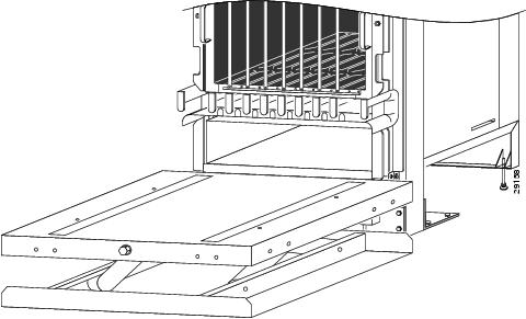

al_roethlisberger Posted January 13, 2019 Posted January 13, 2019 And here is one of my all time favorite tools... the platform jack. I initially bought it to remove the engine from the V11, but I have found many more uses for it since. I think the Dana 50 front differential weighs more than the entire V11 engine. Absolutely a thumbsup on a platform jack, for a myriad of things. I don't actually have a proper automotive platform jack, but many many years ago I acquired something nearly equivalent; which is the installation lift for a Cisco 12000 router. It is essentially a one-time use item that came with the packaging to help one lift and line that monster up with the rack mounts. I don't know what its load limits are, but I know it starts to slightly deform when lifting one corner of my Jaguar, so that would be a bit over 1000lbs. But it is great for lifting various things, and I saved it from recycling specifically for lifting motorcycles. A platform lift specifically for motorcycles would be better because the 12000 lift is really wide, very heavy, and takes a while to lift with since it has a screw lift, but it's pretty good for free. I still may get a real one someday. 1
