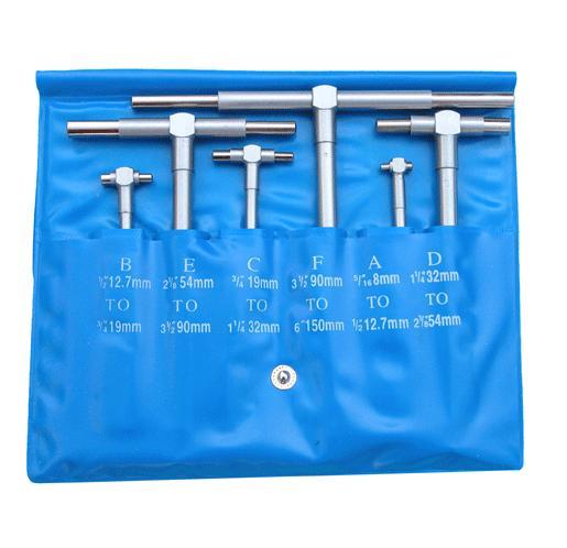

docc Posted June 7, 2019 Author Posted June 7, 2019 3 minutes ago, Lucky Phil said: Brake rotor ridge is no problem docc, just use the calipers in enough of a radial position to avoid the ridges. The other thing you need is a set of telescoping gauges for measuring hole ID's. Use in concert with your calipers. They are as cheap as chips, maybe $30US. Ciao Just what do "telescoping gauges" look like? Never know when I might get the opportunity to "measure hole ID's" . . . I just wanna be ready if the circumstance pops up . . .
Lucky Phil Posted June 7, 2019 Posted June 7, 2019 1 hour ago, docc said: Just what do "telescoping gauges" look like? Never know when I might get the opportunity to "measure hole ID's" . . . I just wanna be ready if the circumstance pops up . . . Like this docc. You compress the ends and lock them via a knurled section on the end of the handle then insert them down the bore or hole and unlock them. You then feel them around until they are at the largest dia point and lock again. Remove and measure with your Mike or vernia calipers. Very cheap, this set is $36.95AU on ebay. Ciao 1
