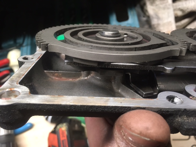

czakky Posted March 22, 2017 Posted March 22, 2017 Is the sheet metal stop plate under the cog, oriented correctly? Should be in neutral.

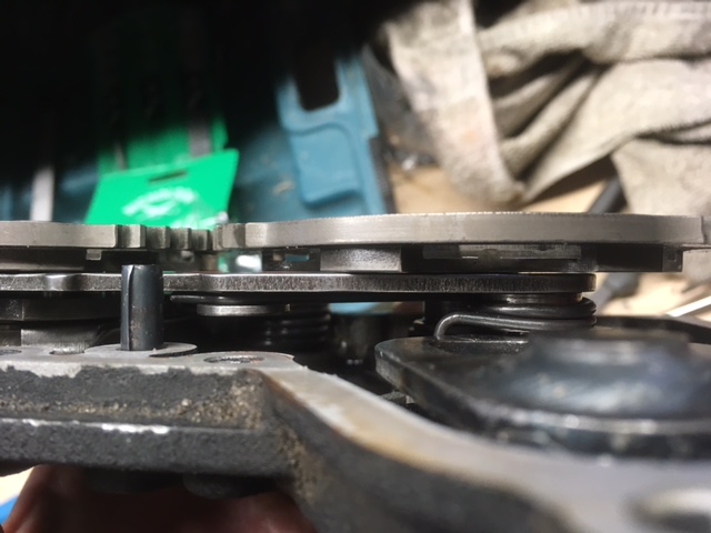

czakky Posted March 22, 2017 Posted March 22, 2017 Also is my pawl spring sitting right? This is a fresh one. It just seems like on the selector side it is barely seated.
Scud Posted March 22, 2017 Posted March 22, 2017 Pawl spring looks right to me. But you can push the coil up and down with a screwdriver to see if you can make it sit better. It will probably just relax into its own best spot after a few shifts anyway. The metal plate under the upper cog only goes in one way. It has a tab that fits a slot on the underside of the cog.

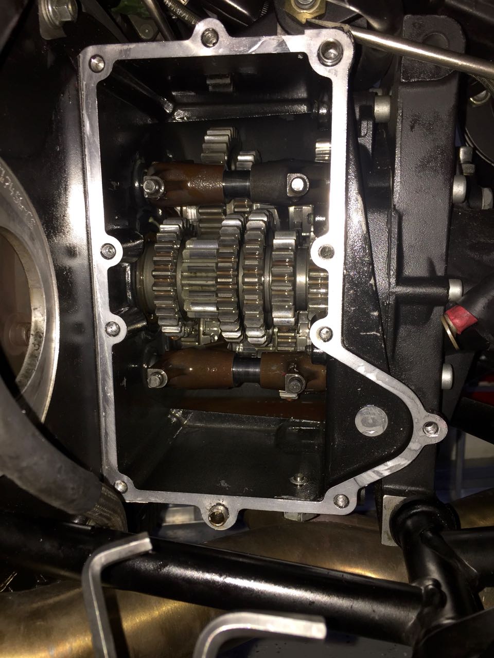

Scud Posted March 23, 2017 Posted March 23, 2017 Pardon my prior playfulness. Here's some actual advice: I needed to re-install a bushing on my pre-selector (since I overlooked it a few days ago). So I took mine off just now. Having done it a few times recently, here are some lessons learned. You want as clear and straight an approach as possible so you don't get sealant everywhere. (How did I learn that???) It's a good idea to dry-fit it first (without sealant) so you have a feel for it and don't get sealant everywhere (again, how do I know?) Loosen the lower nut on the oil return line and wedge the line as far away from the transmission as possible. If your fuel line is in the way (top right) you can wedge a screwdriver in there to keep it above the transmission case. And you probably already figured out that you need to grind down a hex wrench to get at some of the lower bolts. This would not be a problem on the red-frame bikes, because there is no frame rail connecting the engine block to the lower transmission bolt (that goes through the porkchops. 2
