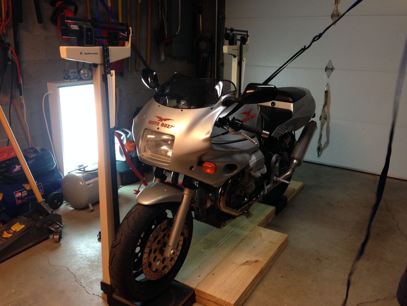

docc Posted August 6, 2016 Author Posted August 6, 2016 I'm assembling a platform to (attempt to) put my Sport up on two classic Fairbanks-Morse physician's scales. One of the other forum members has a Sport1100 that may be getting new front end, and this is one way to try and assess the changes. Looking for a third hand, or some method, to have the rider in place while the measurements are taken. This could certainly go all hair-brained . . . 2

docc Posted August 7, 2016 Author Posted August 7, 2016 Revealing results. We all know the big block Guzzi are "rear weight biased." I thought I addressed this by setting my sags (32mm front/ 25 mm rear) and dropping my triples 5mm. Yet, I carry a good bit of kit in the Tekno panniers (about 18 pounds) behind the rear axle. With Mistral carbon fiber canisters (saves 5 pounds per side) and no US evap system (another 5 pounds), this 2000 V11 Sport weighs 543 pounds/246 kg. Weight distribution, with rider/ Aerostich/ helmet on board: 43/57% front:rear. Curiously, the Sport 1100 showed identical distribution even with sags 25/31mm front/rear. 1

docc Posted August 7, 2016 Author Posted August 7, 2016 Wheelbase measurements were somewhat mystifying, though. The early RedFrame V11 Sport is a full inch (24mm) shorter than the Sport1100/1100 Sport-i: 1471 vs 1495mm, 25º rake vs 26º. (The later V11 "long frames" of 2002 on are 1490/25º). Yet all of our axle to axle measurements are 6 or 7mm (~1/2 inch) shorter than the published specification. Hard to comprehend that dropping the tiples and increasing the rear pre-load/ spring rate could shorten the bike a half inch? Not that I speak any calculus. Could be vagueries in the method . . . "You're a poor scientist, Dr. Venkman."
GuzziMoto Posted August 8, 2016 Posted August 8, 2016 That does sound like a lot of difference from published specs from just fudging the geometry, but I would expect some difference. Also, aside from affecting the geometry, messing with the preloads / sags/ fork heights does not really change weight distribution much. This was noted once or twice way back when in one or two of the argument threads on the subject of front ends and stability. Cars are different in this regard, you can adjust how much weight is on each wheel by adjusting the spring preload for that wheel. It is something very different from the way motorcycles work. Did you measure weight distribution both with the rider and without? I assume the "rider" is of "average" weight? What about measuring the rake? Both with a rider and without....
docc Posted August 8, 2016 Author Posted August 8, 2016 Funny thing, when we weighed the two bikes without the rider, they, again, had identical distribution: 46/54 The Sport1100 with about a half tank of fuel weighed 483 lbs/219 kg and its rider 189 lbs/86 kg in a leather jacket and helmet. The V11 Sport with about 1.5 gallons of fuel weighed 524 lbs/238 kg and its rider 175 lbs/79 kg with helmet and Aerostich Roadcrafter 1 piece suit. (The Tekno panniers and their daily load-out added 18 lbs: 45/55 distribution) We did check the rake but one bike was free standing and the other with rider (more *poor science, Dr. Venkman* ) just to confirm that the earlier Sport has an extra degree of rake (V11 are 25º). 1
