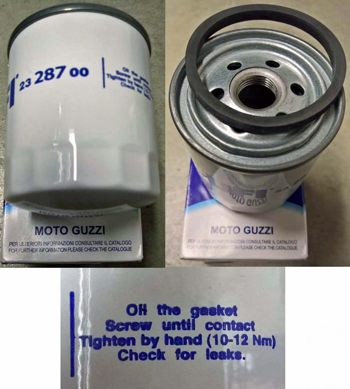

Camn Posted August 25, 2016 Posted August 25, 2016 Quote There is a torque spec for the V11 oil filter? It is printed on the UFI filter. I have saved this from the German V11 site (translation into English my own): “ Tightening torques exist for the UFI filter. The old one (8 layer) 12 Nm, the new one (14 layer) for the Carc models 15 Nm. On both of these filters the on printed tightening torque is 10-12 Nm. To change the filter, you need a filter tool and if possible, a torque tool. Up till 2009 there were oil leaks because of an imperfect seal. Mainly on Norge, Breva, Griso 850/1100, 1200Sport2V, Bellagio and Cali Vintage. Guzzi recommends according the training material from 3/2010 to replace the gasket of the filter with a new gasket Cod. 981115. This gasket has the same measurements, but the material has different properties. If the manufacturing date of the filter is before 2009, the gasket needs to be changed. “ 1
Craig Posted August 26, 2016 Author Posted August 26, 2016 On 8/25/2016 at 5:20 PM, Camn said: Quote There is a torque spec for the V11 oil filter? It is printed on the UFI filter. I have saved this from the German V11 site (translation into English my own): “ Tightening torques exist for the UFI filter. The old one (8 layer) 12 Nm, the new one (14 layer) for the Carc models 15 Nm. On both of these filters the on printed tightening torque is 10-12 Nm. To change the filter, you need a filter tool and if possible, a torque tool. Up till 2009 there were oil leaks because of an imperfect seal. Mainly on Norge, Breva, Griso 850/1100, 1200Sport2V, Bellagio and Cali Vintage. Guzzi recommends according the training material from 3/2010 to replace the gasket of the filter with a new gasket Cod. 981115. This gasket has the same measurements, but the material has different properties. If the manufacturing date of the filter is before 2009, the gasket needs to be changed. “ 12Nm is about 9ft pounds. That seems very low, I can easily hand tighten to 15 foot pounds.
docc Posted August 26, 2016 Posted August 26, 2016 On 8/26/2016 at 12:08 AM, Craig said: On 8/25/2016 at 5:20 PM, Camn said: Quote There is a torque spec for the V11 oil filter? It is printed on the UFI filter. I have saved this from the German V11 site (translation into English my own): “ Tightening torques exist for the UFI filter. The old one (8 layer) 12 Nm, the new one (14 layer) for the Carc models 15 Nm. On both of these filters the on printed tightening torque is 10-12 Nm. To change the filter, you need a filter tool and if possible, a torque tool. Up till 2009 there were oil leaks because of an imperfect seal. Mainly on Norge, Breva, Griso 850/1100, 1200Sport2V, Bellagio and Cali Vintage. Guzzi recommends according the training material from 3/2010 to replace the gasket of the filter with a new gasket Cod. 981115. This gasket has the same measurements, but the material has different properties. If the manufacturing date of the filter is before 2009, the gasket needs to be changed. “ 12Nm is about 9ft pounds. That seems very low, I can easily hand tighten to 15 foot pounds. I tried to simply turn my filter tool on a torque wrench with my (busted-up) bare hand and could not get quite to 9 NM. Looks like 15NM may be more reliable (?) I will endeavor to measure the torque on the "1 & 1/8" turns past contact acknowledging that there are so many variables. 1
Camn Posted August 26, 2016 Posted August 26, 2016 Took some photos, bought this year, made in... "a night in Tunisia"
