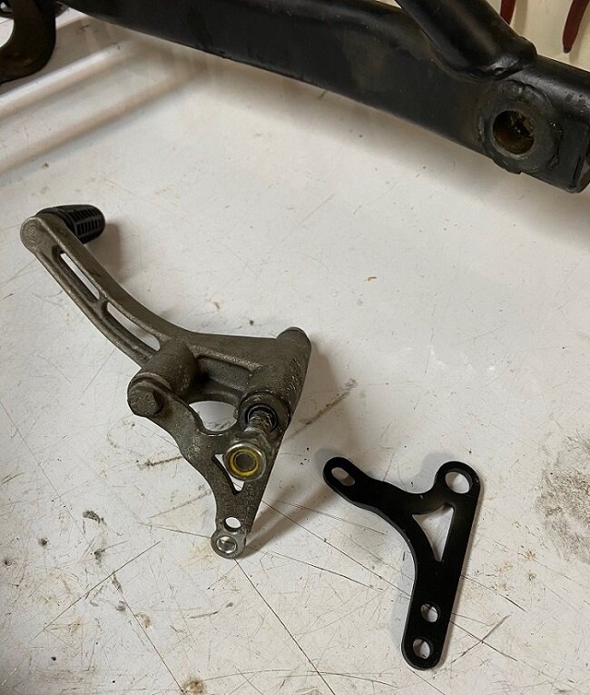

Chuck Posted August 4, 2020 Author Posted August 4, 2020 17 hours ago, Vic said: Hello Chuck, Don't want to be a neusence, but I just wanted to check to see if there's any more interest in a second batch of these. Sounds like your barried in other projects, I can relate to that. I'm getting ready to install a Centauro shift lever on my V11 and thought this would be a good time to upgrade the shift arm. Please keep us posted if you decide on doing another batch. Thanks! The market *may* be saturated. When I first made them, I thought maybe 10 would want them, but it sort of snowballed. I've made a bunch of them since then. I put a "factory reject" on the Mighty Scura to finish the last order, so I'm tapped out. The easiest thing for you to do is simply weld an extension on your OEM lever. I think that's what Lucky Phil originally did. 1

Chuck Posted August 4, 2020 Author Posted August 4, 2020 Thanks. If I were doing it, I'd cut the shifter off square, make the extension to fit that, chamfer both sides 45 degrees, clamp them down and weld a small bead on both sides. Do a good job, and it would be hardly noticeable. 1
gstallons Posted August 5, 2020 Posted August 5, 2020 20 hours ago, Chuck said: The market *may* be saturated. When I first made them, I thought maybe 10 would want them, but it sort of snowballed. I've made a bunch of them since then. I put a "factory reject" on the Mighty Scura to finish the last order, so I'm tapped out. The easiest thing for you to do is simply weld an extension on your OEM lever. I think that's what Lucky Phil originally did. I made my first one before I saw this . I just made an extension that the extra distance would clear the frame and used the two holes in the original lever and used two 6mm bolts to mate the two together . This was so if I didn't like it , I could go back to original . 1
