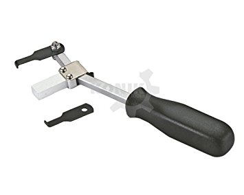

MartyNZ Posted April 10, 2017 Posted April 10, 2017 Yes, you can easily replace a seal with the shaft in place. If you search for "seal removal tool" you will see there are lots of tools that can help you. I use one like this to remove seals while the shaft is still in place: It is unlikely that you will remove the seal without damage to the seal, so you should try to have a replacement in your hand before you wreck the old one. Be careful not to scratch the shaft or seal housing as you pry it out. Have you seen this posting? http://www.v11lemans.com/forums/index.php?showtopic=19778
