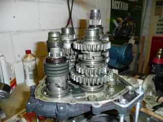

kglm Posted October 20, 2016 Posted October 20, 2016 If you just fix leaking there no need remove axels: take off first cover , use 01912530 support tool and turn box , all axels stays in place second cover. -KG- 1
Scud Posted October 20, 2016 Author Posted October 20, 2016 Oh - now I understand. I assumed it would be easier to remove the small cover, but instead, it's easier to pull the larger case off. So I would need to remove the input hub (the part that mates to the clutch disc) - no special tool for that? The shop manual only describes a complete tear-down, not the minimum steps needed to fix a leak.

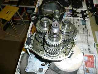

andy york Posted October 21, 2016 Posted October 21, 2016 So ... let me get caught up A: tranny is out and the back cover is off B: Then the intermediate plate w/shafts was pulled out Unless you just want to disassemble the shafts there is really no reason to. Clean everything well, look at the inside of the case for cracks or a source for the leak. could be that it just plain ol lost its seal. A fastener could have been a little loose. anyway I use yamabond most of the time. you may want something that will set a little slower for the tranny cause its not gonna go back together lickity split. . just be sure and let the stuff cure for a day or overnight before you add lube. I can write a small dissertation on these things. So, rather than babble on, I will wait for more specific questions. I also have one apart in the shop if I need to get touchy feely with the thing. got your note and will touch base before shipping
Scud Posted October 21, 2016 Author Posted October 21, 2016 Thanks to everyone for all the help and discussion. Where else can you get advice from so many helpful and knowledgeable people? Norway to Nashville. Finland to Fotoguzzi. To Andy's questions: My tranny is out and 100% intact. Pictures in this thread during process are from people who were showing me how to take it apart. My plan of attack is: Degrease Strip paint (good riddance to wrinkle paint) Remove preselector (and rebuild) Remove rear cover Remove main case (shafts and gears stay with intermediate case). I think this is the only step where I will need a special tool to remove the input hub. Inspect for cracks/source of leak(s) - address if needed/possible Paint Reassemble with Threebond 1211 (it's equivalent to all the the other sealants that everyone likes, I already have a tube, and last, but by no means least.... I think I will be able to swear more profusely if I use what Pete recommends.) Carefully torque everything to spec (and be patient before adding lube and reinstalling on bike). I'll report findings/progress as events warrant.
andy york Posted October 21, 2016 Posted October 21, 2016 Sounds like a plan to me. This is just me, but I would put in new seals( input and output), maybe there is an o-ring behind the input shaft hub, the star washer that goes on before the nut. Hate to go through all this and find out you nicked a seal. i will send input hub wrench, couple of sockets for hub nut. i have the tools to hold the case in vise and the intermediate plate in a vise also. will try and email some pics to ya. I don't seem to be smart enough to resize my pictures to fit here 1

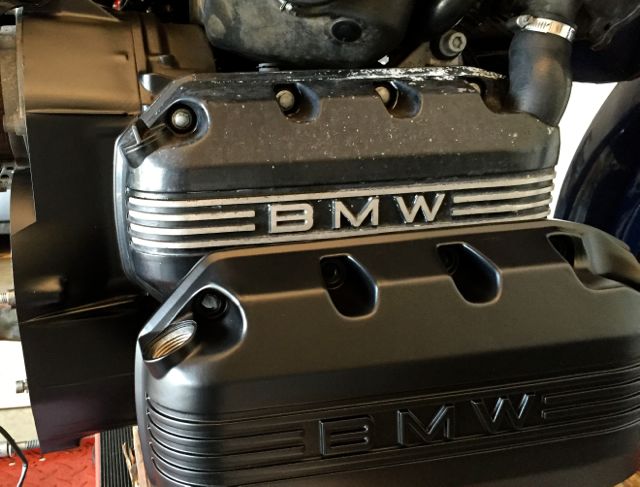

MartyNZ Posted October 21, 2016 Posted October 21, 2016 On 10/21/2016 at 2:37 AM, Scud said: My plan of attack is: Degrease Strip paint (good riddance to wrinkle paint)7. Paint Can you powdercoat your gearbox? Is it realistic, and does it offer any advantage over paint? I have the same problem with bubbling paint and unattractive finish, but thought that powdercoat may be more durable. What made you select paint over powder?
Scud Posted October 21, 2016 Author Posted October 21, 2016 Tempting, and more durable, as powdercoating is - the problem is that the parts get sandblasted and baked at high temperature. That means every bearing and seal has to come out. So if you don't mind a total tear down, it's fine, but I am also going to strip and spray the engine case (without tear-down) and would like the cases to have exactly the same finish. I already powdercoated the alternator cover, swingarm, lower subframe, and driveshaft collars. Benefit of a parts bike is that you can send stuff off for powdercoating and keep it on the shelf till you're ready to install. Back to paint... I've been using VHT satin black engine case paint on my BMW. It gives a really nice finish, very close to the flat black powdercoat. For example, I sprayed this bell housing in place. The crank cover was powdercoated - and you can see how neglected it was when it followed me home. 1
