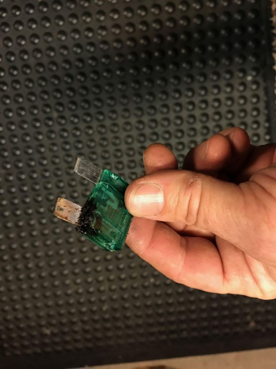

docc Posted August 3 Author Share Posted August 3 Even the large "Maxi" fuse I tried failed because of the contact heat. Original post... 2 1 2 Link to comment Share on other sites More sharing options...
