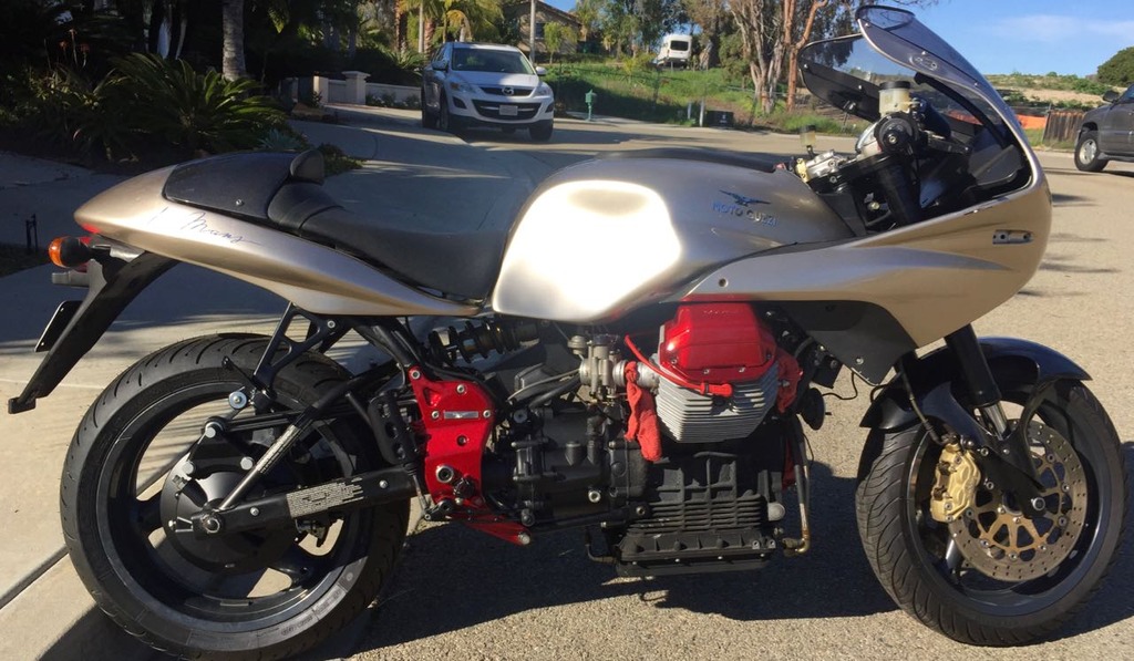

Scud Posted March 3, 2017 Author Posted March 3, 2017 Well Chuck, to each their own. I think I would have put black gaiters on the Aero Lario. But if you want some audacious... I put the side-stand on and wheeled this one out into the sun. ...and now that cylinder head paint doesn't look so good... 1

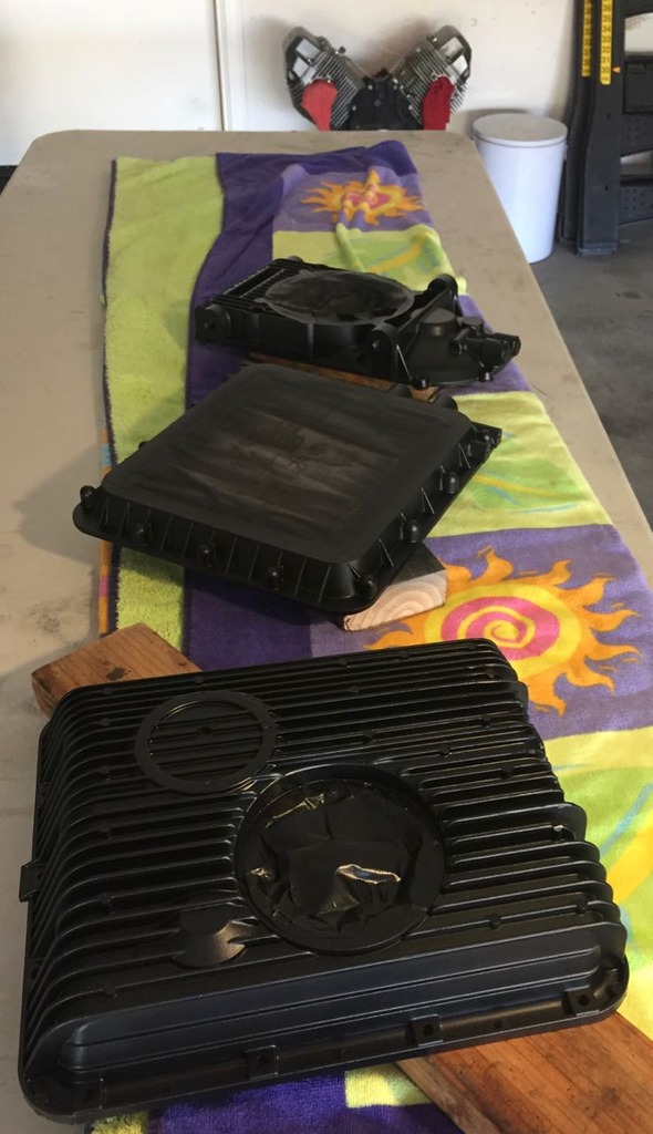

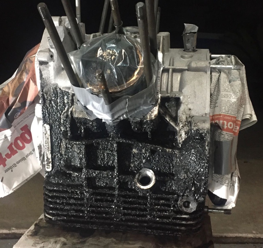

Scud Posted March 19, 2017 Author Posted March 19, 2017 Engine cases all painted. That leaves the block, and maybe the heads (since the silver paint is bubble-peeling on fins). Interestingly, the upper sump ring had silver paint under the wrinkle paint. Must have been a re-paint at the factory. Twice the stripping fun for me...
Lucky Phil Posted March 20, 2017 Posted March 20, 2017 Hey Scud what brand of paint are you using? Ciao
Scud Posted March 20, 2017 Author Posted March 20, 2017 VHT Engine Case Primer and VHT Engine Case Satin Black

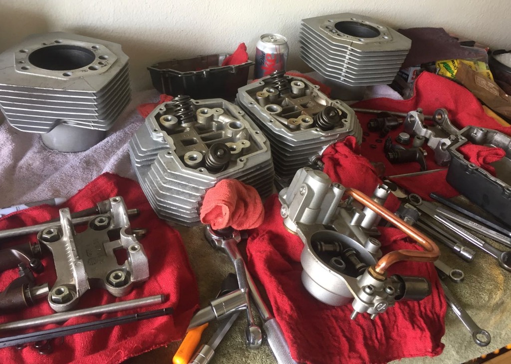

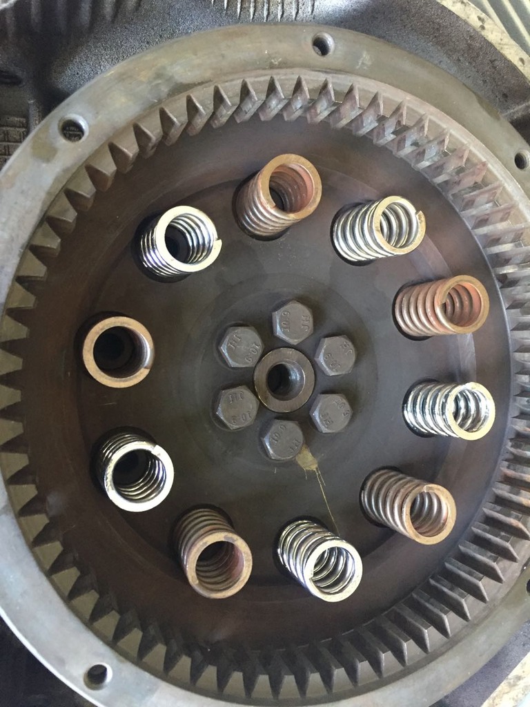

Scud Posted March 26, 2017 Author Posted March 26, 2017 Popped the clutch in - with alternating original and stiffer springs. Lesson learned on my last clutch mis-adventure. Hopefully this one will be a one-shot deal. And I slipped on the slippery slope... engine stripping in process. The engine looks brand new inside. Gears and chain look great, heads are barely even discolored. Bore marks still visible in the cylinder walls.
