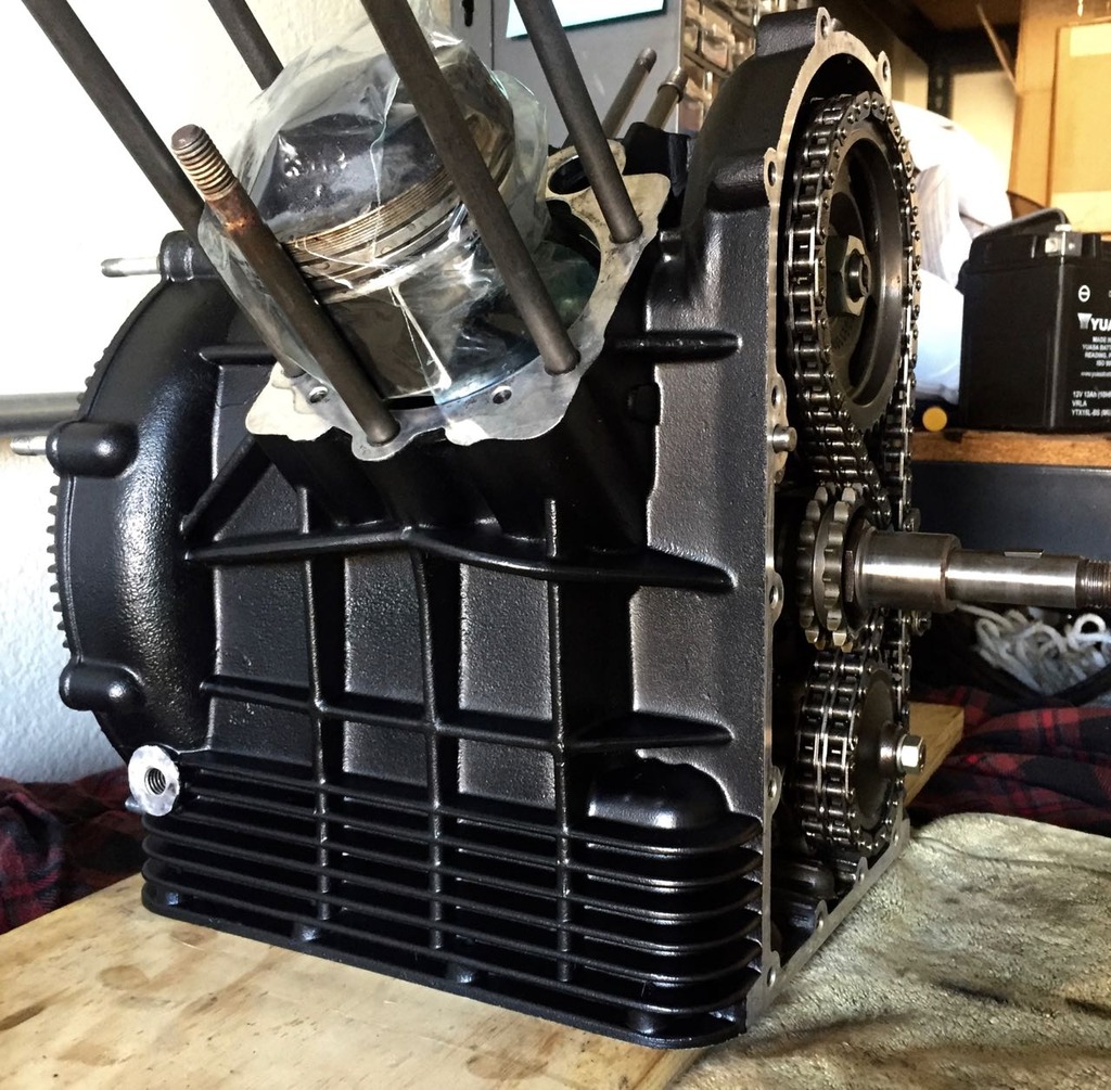

Scud Posted March 27, 2017 Author Posted March 27, 2017 But the ending is happy So there she sits for another week while I will be away for work. But that gives me to time get some supplies. And I could use some advice, because this is first time I've put pistons in anything. I'm going to get new base and head gaskets (one of each was damaged during removal). It looks like a good idea to replace all the O-rings around the long studs - between block and cylinder, and up top, at the head. I'll get new O-rings for the access plugs on the heads. Questions: One of the top studs came out with the special cap-nut (the one under the oil line). Any worry there - or just separate them and reinstall the stud? How should I install the cylinders over the pistons? Please treat me like I don't know anything about this, because I don't. Tools... cleaning... assembly lube... what do I need to know? 2

Scud Posted March 27, 2017 Author Posted March 27, 2017 Hmmm... this is going to be one of those "I should have read the instructions" moments. This was only supposed to be a paint job. Motor only had 12,000 miles and I had not planned on taking it this far apart. But it was such a PITA to strip my Scura engine with the cylinders on... This was much easier for stripping and painting. I also thought about just raising the cylinder a little - but then one stud came out and one base gasket tore a chunk off when I lifted the cylinder. So - I should have disconnected the pistons from the rods and left them in the cylinders? That seems like it would be have been a good idea. Therefore - I suppose I should remove the pistons and install them in the cylinders? I have whole week to figure this out. Gotta fly tomorrow AM.
JesterGrin_1 Posted March 27, 2017 Posted March 27, 2017 Hmmm... this is going to be one of those "I should have read the instructions" moments. This was only supposed to be a paint job. Motor only had 12,000 miles and I had not planned on taking it this far apart. But it was such a PITA to strip my Scura engine with the cylinders on... This was much easier for stripping and painting. I also thought about just raising the cylinder a little - but then one stud came out and one base gasket tore a chunk off when I lifter the cylinder. So - I should have disconnected the pistons from the rods and left them in the cylinders? That seems like it would be have been a good idea. Therefore - I suppose I should remove the pistons and install them in the cylinders? I have whole week to figure this out. Gotta fly tomorrow AM. Well that is up to you lol. You can leave them on the connecting rods and then try and hold the cylinder correctly and slid them over the pistons but I have found doing so to be a pain lol. So yes I would just slide the pin through one side to remove the piston and then reassemble them on a bench that way you can clean everything easier and put on the new gaskets and everything else and then just slide everything back together. Just make sure to keep the pistons oriented in the correct direction. I have just never removed pistons from cylinders without replacing the rings with a new hone on the cylinders to enable the new rings to seat. As now when you reassemble the pistons into the cylinders the rings will have to seat themselves into cylinders again. And since they have been previously worn in I am not positive of there life span or if they will seat correctly for a good ring seal. But I have heard of people reusing rings. I have just never taken the chance.

Lucky Phil Posted March 27, 2017 Posted March 27, 2017 VHT Engine Case Primer and VHT Engine Case Satin Black Thanks, will be interested to see how durable it is. I need some grey for the Daytona cases. At 12,000 miles I'd do nothing but repalce the gaskets an O rings. Pull the pistons and install them in the cylinders with a piston ring compressor from the cylinder base. They are cheap and if you break a ring you'll need to buy a full set which isnt cheap. You need a ring compressor, everyone does, doesnt need to be an expensive one. Ciao 1
Scud Posted March 27, 2017 Author Posted March 27, 2017 VHT Engine Case Primer and VHT Engine Case Satin Black Thanks, will be interested to see how durable it is. I need some grey for the Daytona cases. Ciao It's holding up really well on my BMW transmission and driveline - and so far so good on the Scura. Note that the Engine Case paint is different than the Engine Enamel - I'm not sure how it's different, but the case paint says it's specifically for motorcycle engines. I got a can of VHT's Engine Enamel in a color they call Nu-Cast Aluminum. I'm hoping that will be a good match for the cylinder heads.
Chuck Posted March 27, 2017 Posted March 27, 2017 Scud.. you can do it either way. If you want to install the cylinder over the piston, you can slowly work it down by pushing each ring together with your fingers, or use a ring compressor like this. The trick with these is to lube everything up well, tighten the compressor just enough to make the rings flush with the piston, and give the cylinder a good smack with your rubber hammer. The idea is for all of the rigs to go into the cylinder with that one swat. Being hesitant about it will (probably) leave the oil ring still out of the cylinder. The old rule used to be if the rings came out of the cylinder, to glaze break it and install new rings. Not so much any more. I wouldn't bother at that low mileage..

Lucky Phil Posted March 27, 2017 Posted March 27, 2017 Scud.. you can do it either way. If you want to install the cylinder over the piston, you can slowly work it down by pushing each ring together with your fingers, or use a ring compressor like this. The trick with these is to lube everything up well, tighten the compressor just enough to make the rings flush with the piston, and give the cylinder a good smack with your rubber hammer. The idea is for all of the rigs to go into the cylinder with that one swat. Being hesitant about it will (probably) leave the oil ring still out of the cylinder. The old rule used to be if the rings came out of the cylinder, to glaze break it and install new rings. Not so much any more. I wouldn't bother at that low mileage.. Hey Chuck, identical to the one I use most often. Ditto on the methodology. Ciao
