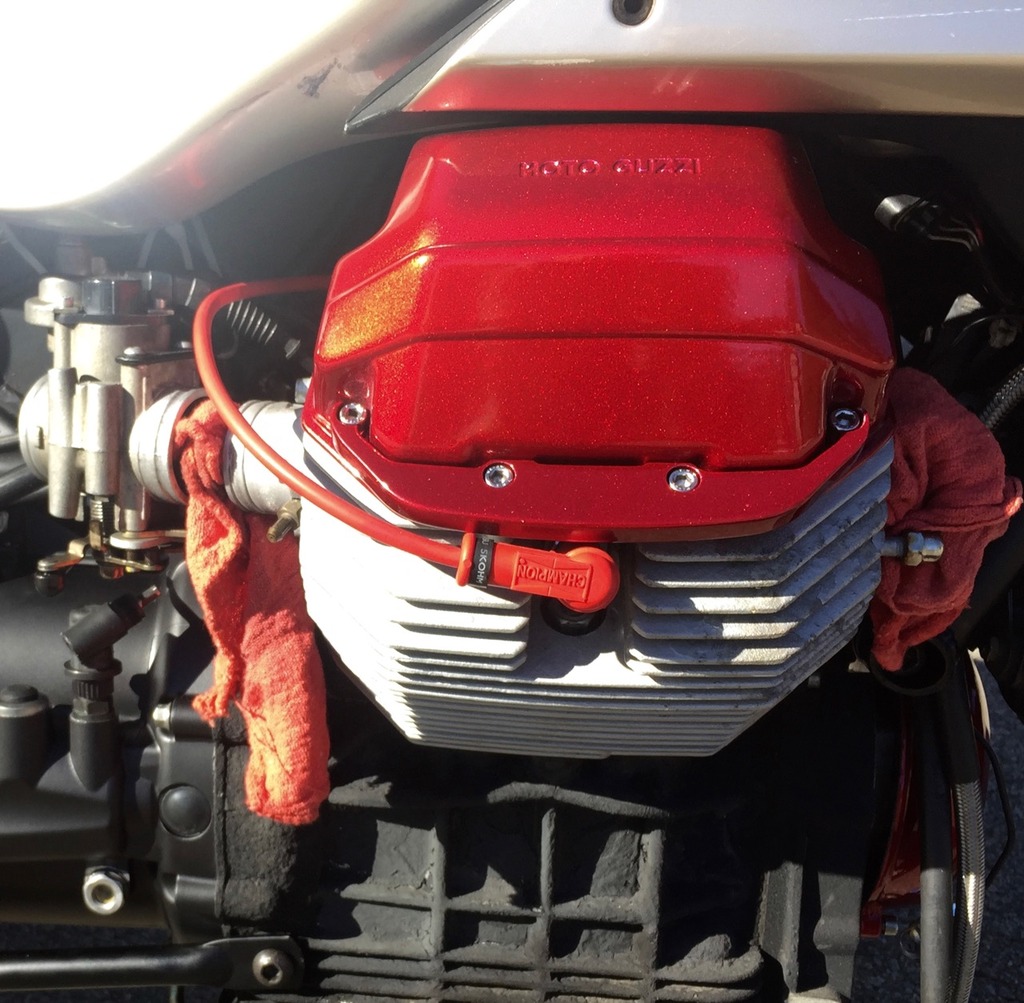

Scud Posted March 29, 2017 Author Posted March 29, 2017 Thanks again. I ordered one of the "pictured" compressors so I would have the option of leaving the pistons on the rods. Ironically, I ordered it on Amazon - and my hotel in Seattle looked out directly on Amazon world headquarters. Too bad no time to visit Moto International - maybe next time. So... here's the paint on the heads, which was part of the motivation for removing them (to repaint). Has anybody repainted the heads? The fins are really deep and I don't think I will be able to get good paint coverage. It difficult to coat even the shallower fins on the engine block and timing cover. I like Knumbnutz's engine with that special blasting - but I assume that means removing the valves, which I'd really prefer not to do. It would be a moral failure to install a flaky-paint head between that candy-apple cover and a fresh, black, block. Any advice appreciated.

Lucky Phil Posted March 29, 2017 Posted March 29, 2017 Thanks again. I ordered one of the "pictured" compressors so I would have the option of leaving the pistons on the rods. Ironically, I ordered it on Amazon - and my hotel in Seattle looked out directly on Amazon world headquarters. Too bad no time to visit Moto International - maybe next time. So... here's the paint on the heads, which was part of the motivation for removing them (to repaint). Has anybody repainted the heads? The fins are really deep and I don't think I will be able to get good paint coverage. It difficult to coat even the shallower fins on the engine block and timing cover. I like Knumbnutz's engine with that special blasting - but I assume that means removing the valves, which I'd really prefer not to do. It would be a moral failure to install a flaky-paint head between that candy-apple cover and a fresh, black, block. Any advice appreciated. I wonder if powder coating would work, you'll get the coverage but dont know about the heat tollerance around the exhaust port. Cylinders should be fine. Ciao
Tom M Posted March 29, 2017 Posted March 29, 2017 I repainted my heads when I had them off about five years ago. I used some kind of high heat spray paint from the auto parts store. Probably VHT but I can't be sure. They're holding up just fine.
Scud Posted March 29, 2017 Author Posted March 29, 2017 I think you know the answer, and you don't like it. Probably some truth to that. But I was hoping to hear something like this.... I repainted my heads when I had them off about five years ago. I used some kind of high heat spray paint from the auto parts store. Probably VHT but I can't be sure. They're holding up just fine. So Tom, do you recall if you stripped the old paint off, followed by prime and paint - or did you just rough 'em up and apply a fresh color coat? I was thinking about the rough-and-color approach.
Tom M Posted March 29, 2017 Posted March 29, 2017 I didn't strip the old paint Scud. I just cleaned it and lightly sanded the fins where the factory paint was peeling.
