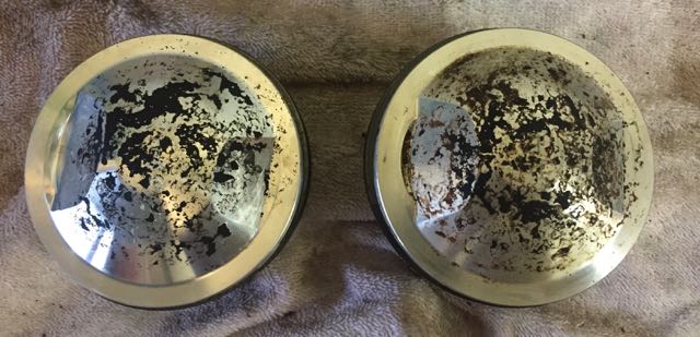

Scud Posted April 5, 2017 Author Posted April 5, 2017 So... I soaked it Simple Green for an hour last night, then chipped some away deposits with a plastic scraper, then put it in the ultrasonic (with only water) and ... then soaked it face down again in a shallow pool of Simple Green overnight... and this is probably as clean as it's gonna get. Phil - are you using some kind of solvent in the Ultrasonic cleaner? I just used water for three 10-minute cycles and it didn't break much loose.

Scud Posted April 6, 2017 Author Posted April 6, 2017 Thanks again for the reminder about ultrasonic. I did a little more reading to figure out how to use it correctly. And here are two excellent results: The piston on left is the one that I soaked overnight twice and did a lot of brushing and scraping. On the right, this piston spent 20 minutes in the ultrasonic cleaner with diesel fuel. I also read about an interesting technique. You can place small parts in a plastic bag with just a few ounces of solvent, and fill the ultrasonic cleaner with water - and drop the bag in the water. I put these head nuts and washers in a bag of CLR (calcium, lime, rust remover) and ran the cleaner for 10 minutes. One of the cylindrical nuts was so rusty that it pulled the stud out of the block. Now even the inside of the threads are spotless. 2
