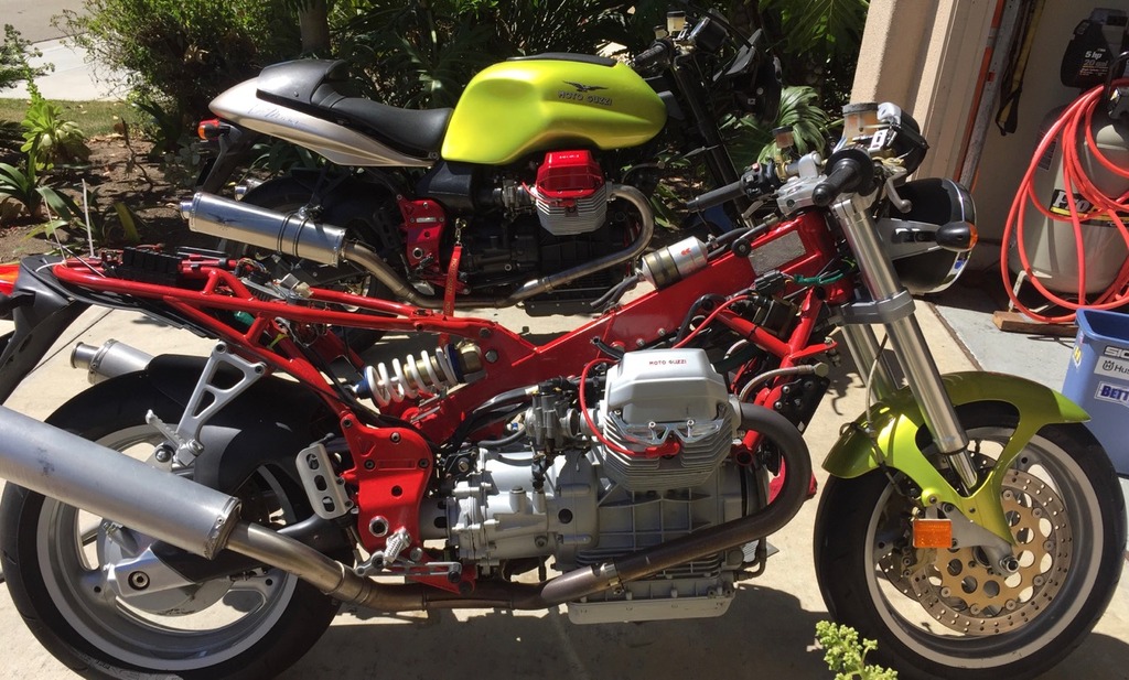

Scud Posted May 18, 2017 Author Posted May 18, 2017 I found some RaceCo specs at those tolerances and Meinolf seems also to get good results with looser settings. As I understand it (and I'm open to being corrected) loose settings are also good for extreme heat and I do sometimes venture off into deserts and mountains in the summer. So here's the fun news... she moved under her own power today for the first time in several years. Shifted smoothly up and down through all 6 gears - but I only lugged it up and down the street at low RPMs. Idles and purrs along very nicely at low RPMs. So... it seems we almost have a motorcycle... and would you look at that red stiletto? Without any nasty silver clutter around it to distract from it's shapeliness... It's still clacky, especially on the right. I checked all the stuff that Tinus and Chuck suggested and did not see any problems. The valves were still at the clearances I had set. So I poured some oil in the pushrod area and squirted it around everything else in the heads that still looked dry. Started it - still noisy. Set the valves to .006 In and .008 Ex. Started again and here is the video. It shows the LH for a couple seconds then goes to the RH, which seems to be where the noise is coming from. http://vid1128.photobucket.com/albums/m492/timscudder/Champagne%20LeMans/IMG_6152.mp4 I think it's a little quieter than before, but I still don't like the noise. I must say it was fun seeing it run with the covers off. That alone was worth the effort.
