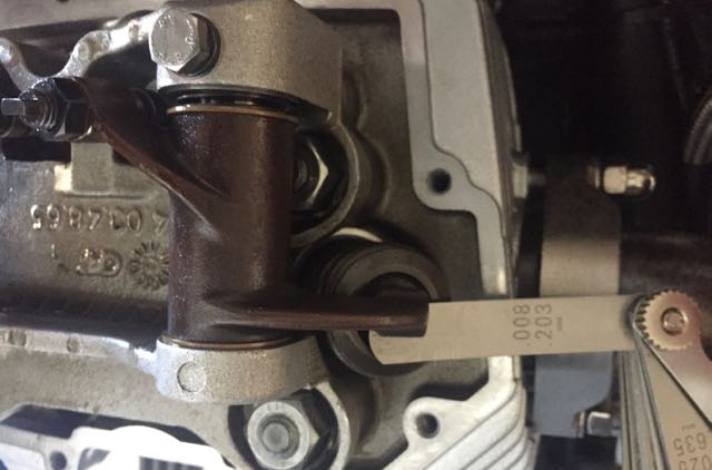

Scud Posted May 19, 2017 Author Posted May 19, 2017 Sooo.... pushrods are straight, they make a nice popping sound when coming out of the lifters. There is a little worn spot on the rocker for the RH exhaust valve. This causes a .001" difference in measured clearance. Measured as shown, I get .008" but if I insert the gauge at 90 degrees from the picture it feels more like .007" This is interesting... but was not enough to change the noise I'm hearing. Now I'm feeling stuck. I'm concerned that there may be an internal problem. Maybe I should haul it over to the dealer and pay for a diagnosis? I may have to push her in the corner for a time-out while I focus attention elsewhere. My ridiculously reliable and un-fussy K75s needs an oil change... the Husky needs some attention before an upcoming mountain adventure... the truck needs some love... and then there is a Greenie with a different sort of puzzle waiting to be solved... and this is prime riding season... and there are rideable bikes on call... in fact, I feel a night-time canyon-raid coming on...

Chuck Posted May 19, 2017 Posted May 19, 2017 Scud, it's hard to tell from that picture, but it looks like there is a dimple or something on the rocker face. That ain't rat. The second question to me would be why is it there? I'd catch up on my other maintenance chores and ruminate on it a bit. The *last* thing I'd do is take it to a dealer and have that kid that cross threads your spark plugs trouble shoot it.
Scud Posted May 19, 2017 Author Posted May 19, 2017 There is a flat spot on the rocker face and I can feel a little lip with my fingernail. It's kind of hard to see and I had to get the light *just right* to show it. This causes the .001" measurement difference - but what caused the wear in the first place? I thought the fuel pump was going to be last hurdle. Yes, take care of other stuff... go riding... clean the garage... ruminate...
Chuck Posted May 19, 2017 Posted May 19, 2017 I'd get it resurfaced or put a new/different one on there. Not knowing the history of the engine.. maybe someone gapped it way too wide and ran it that way a while? Maybe the cam is starting to wipe a lobe? Or already has? I'll take door number 1.

bbolesaz Posted May 19, 2017 Posted May 19, 2017 Bad RH Exhaust valve guide ? Something is causing the deformation on the rocker face.
