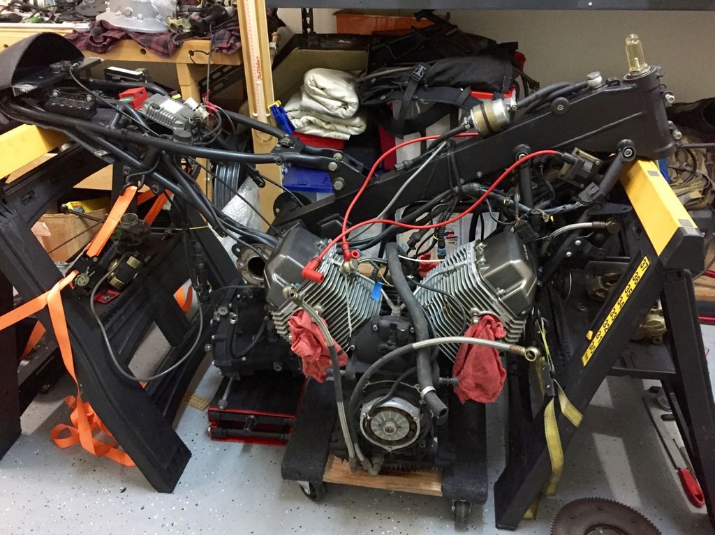

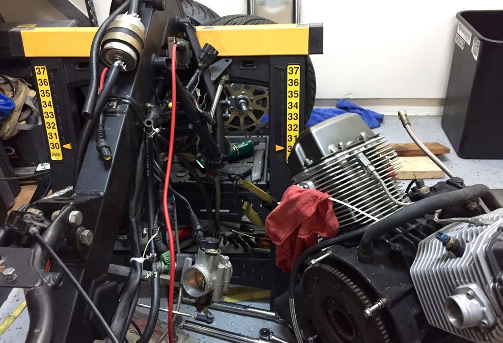

Scud Posted January 14, 2017 Author Posted January 14, 2017 Spine Raid in my garage!! It's a fun puzzle to put this bike back together with the best of whatever bits I have... I grabbed the rear axle from the parts bike today, because the Champagne's rear axle had clearly been overheated, probably during a wheel-bearing failure. And the clutch and brake reservoirs and brackets from the Scura (from when I put those pretty Rizoma tanks on).... and... and... and... now I need to "re-organize" and get myself some working space again.

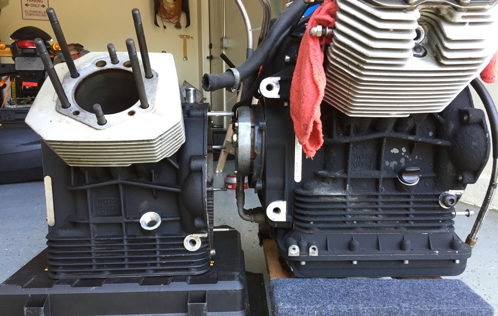

Scud Posted January 15, 2017 Author Posted January 15, 2017 Which engine to use? That's pretty easy - the complete one. However, I thought some of you might be interested to see two 2002 cases side by side. On the left, we have a case that was replaced under warranty and has done about 50,000 miles. On the right, we have a case that was not replaced - and you can see how the paint is starting to bubble and peel. This engine only had 12,000 miles on it - and it's likely to get much worse. I think I'm going to put the engine in as-is. The thought of stripping and repainting another engine is just more than I can bear. The transmission cleaned up well, but the paint also starting to bubble. I am going to repaint all the crinkle-painted parts behind the transmission (driveshaft collars, final drive case, and reaction rod). Joe had already repainted the final drive in Harley crinkle, but I'm going to put in the lower-milage one, which was already peeling badly. Here's a how a spine-frame would look as an inline V-twin. And if this is discovered, I think I will get penalized for "illegal use of corner." At least it's all freshly degreased... And if I may add... 50,000 miles can make quite a disgusting and stubborn mess inside an airbox.
