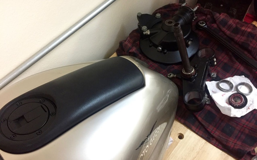

Scud Posted January 22, 2017 Author Posted January 22, 2017 Got a little more play-time today. Some highlights: Painted the final drive and reaction rod. Tried cleaning and greasing the steering bearings, but they were too far gone - so I finally had to get a real hammer and punch out the races... bearings on order. And I had previously powdercoated a spare fuel door - so took the opportunity to install that.
docc Posted January 22, 2017 Posted January 22, 2017 It was so thoughtful of you to put a paper towel down for the greasy bearings to look after the wife's plaid tablecloth. She hasn't asked about her cutting board yet?
Scud Posted January 22, 2017 Author Posted January 22, 2017 Funny interpretation Docc. That's a woodworking bench and it does sort of look like a cutting board in that picture. And that's Joe's old flannel shirt. He wrapped a bunch of parts in clothes before he shipped the project to me. I'm doing this project in the "small" garage. My house has a 3-car garage - split into a 2-car (but truly a 1-car with bicycles and surfboards) and a 1-car (aka 4-motorcycle). The Scura project recently hogged the 2-car for months - and she had to park outside. She recently discovered my stash of clean plastic parts in my daughter's room (she is away at college and we keep her room closed while she's gone.) I was at work during the "discovery" and I received a text with the word "hoarder" in it. Don't know why... ...but as long as she can park in the garage the "problem" is not out of control. More rain today... a lot more rain... so I am just trying to get everything clean, organized, adjusted, lubed, etc. so assembly will go quick when I get all the goodies back from the powdercoater. Steering bearings were an unpleasant surprise. I confess to trying my new ultrasonic cleaner in the kitchen while she was away (you can see the kitchen counter under the paper towel). Swore my youngest daughter to secrecy in the name of "scientific experimentation." Here are some front brake caliper parts before and after 10 minutes of ultrasound with nothing but tap water in the tub. Then I cleaned her wedding ring in it... ultrasonic...
