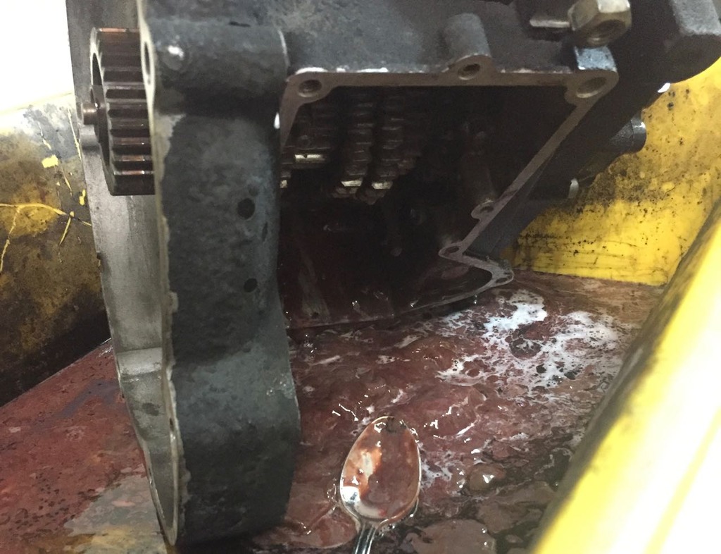

gstallons Posted January 23, 2017 Posted January 23, 2017 If you have compressed air , use it to blow out the goo . The safest "solvent" would be kerosene or diesel fuel . Less flammable than gasoline . Finish off with Brake -Kleen . Clean the Clutch hub off with a wire brush on a handle ( it looks like a tooth brush for the Tin Man ) then a liberal amount of dry film graphite spray .
MartyNZ Posted January 23, 2017 Posted January 23, 2017 Drained the oil... nothing came out... What is the temperature in your garage? Would that goo drain out if you warmed the gearbox with a portable heater?
docc Posted January 23, 2017 Posted January 23, 2017 Ordinarily, we would all drain our various oils at "operating temperature?" This one had to be uncorked ambient? I wonder if it would have *liquefied* more (and drained better) at "operating temperature?" Even with that, I agree that RedLine Heavy was long past it's due date!
Scud Posted January 23, 2017 Author Posted January 23, 2017 Thanks guys. Some answers: It's a little colder than normal - just had an Orca sighting off Carlsbad (they rarely come this far South). Garage is about 55F (13C) - it's been raining all day, on and off last 2 weeks actually, we're having historic snowfall in the mountains and we may be coming out of drought conditions here in California. The Pacific Ocean is kicking our asses right now. Big swell coming... maybe up to 12 foot sets. Took the kids to the beach this afternoon. High wind advisory. The transmission had to be drained at ambient temperature, because the tranny was out of the bike, which has not run for several years. I do have access to compressed air, but I have visions of Gallagher smashing a watermelon with a sledgehammer.... and I was thinking diesel fuel too. I prefer not to work with stuff that can catch on fire or explode. Sometimes diesel is even cheaper than gas. I got all the big sludge out with spoon, towels, and Super Clean. Everything turns well and the shift arms slide freely. I think I will run a little diesel fuel through it next week, and then one more flush with gear oil so it can sit till I'm ready to seal it up again. Gonna get the pushrod and throwout bearing out too (but slave cylinder bolts are not turning yet). I really appreciate the help/advice. I've heard stories about sludge-piles like this, but I've never seen it before and had no idea what to do. Squeamish alert.... And in better news... the 12,000 mile engine from my crashed parts bike is super-clean inside. I got the valve clearances set, new plugs, and I think I will pull the clutch discs out again and do the graphite treatment, along with the spline.

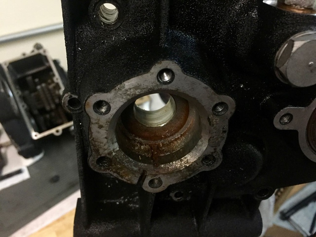

Scud Posted January 27, 2017 Author Posted January 27, 2017 Well, having lost a few days of shop-talk from this thread, let me try to recap the posts that went missing. I was disturbed by a groove in the bore for the clutch push-rod. I got some good advice and offers to help and Chuck posted a cool video of his shop and airplanes and Guzzis. We all now wish Chuck was our neighbor. We talked about throwout bearings and all the parts that go between the slave cylinder and the pressure plate. And I managed to get the bore honed at a local machine shop. And the inside of the tranny is looking pretty clean after a bath in diesel fuel.

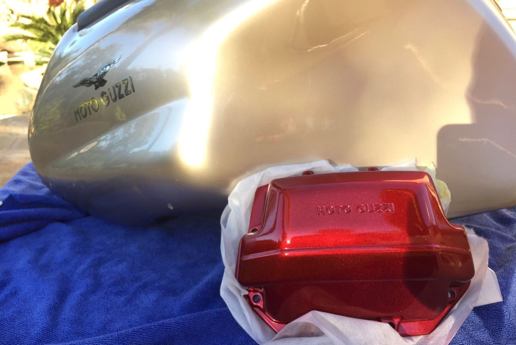

Scud Posted January 27, 2017 Author Posted January 27, 2017 Picked up my powdercoating today - and just had to see how the covers look by the tank... Champagne and Candy-apple Red. 3
docc Posted January 28, 2017 Posted January 28, 2017 Picked up my powdercoating today - and just had to see how the covers look by the tank... Champagne and Candy-apple Red. That is so-freakin'-gorgeous! I had to re-post the photo. Stunning!!
Scud Posted January 28, 2017 Author Posted January 28, 2017 Wait till you see the porkchops and alternator cover... I'm just a tease now...
czakky Posted January 28, 2017 Posted January 28, 2017 Some lucky sunuvagun's gonna get a sweet bike... if you sell her.
footgoose Posted January 28, 2017 Posted January 28, 2017 YOWZA! that is nice! filling in the lettered area? gold? .... too much maybe?
