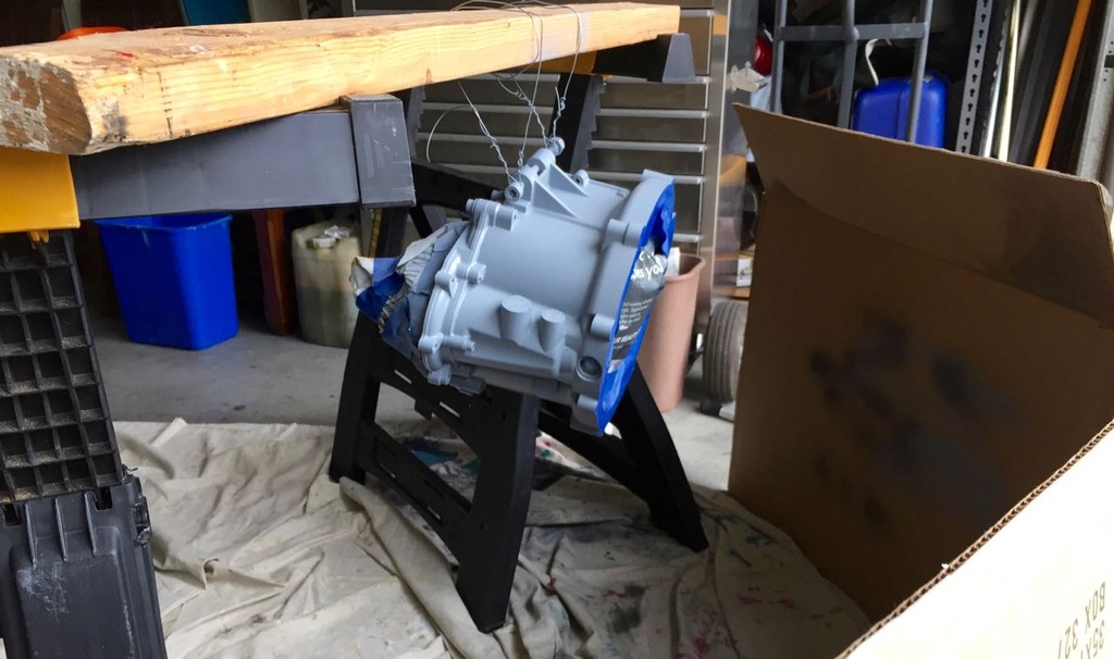

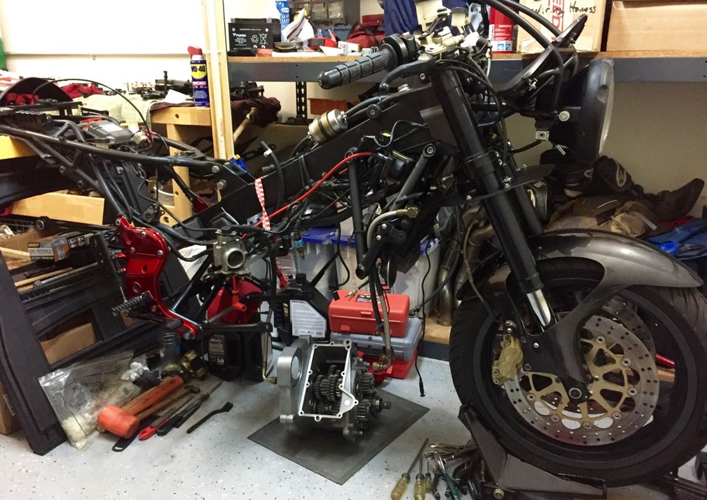

Scud Posted February 5, 2017 Author Posted February 5, 2017 The LH bar was slightly bent from going down - which made getting the bar-end weight out a bit "challenging." So I squeezed it back into alignment. Then got the front end back together, including putting the original clip-ons back on, new grips, new-ish reservoirs, some new stainless fasteners, etc. Hand-me-down Omron relays from my Red LeMans. Stripped the bubble-paint from the tranny - then gave it one more flush with diesel fuel because the pink-goo was still slowly oozing out of places. I think it's finally clean. I know I said earlier to conduct an intervention if I start to paint another drivetrain... but I cannot put the bubble paint engine and transmission next to that luscious candy-apple powdercoating. Interventions must be held in person. Bring goggles and a long sleeve shirt... On paint: With my new IR thermometer and portable space heater, I was able to record a 160-degree surface temperature on the fork bottoms. That'll have to do. I'm going to bake the transmission covers in the oven, but will just point the heater at the main case, which still has a lot of oil in it. It's a good idea to harden it as much as possible before assembly.
Scud Posted February 5, 2017 Author Posted February 5, 2017 Here's my "spray-booth." I had to dig the sawhorse out from under the project to pull this off. I think stuff looks cool in primer grey.
docc Posted February 6, 2017 Posted February 6, 2017 Primer gray does have a cool light effect. Hey, wait . . . that's basically what color my Sport is . . .
JRD Posted February 6, 2017 Posted February 6, 2017 I think Scud is THE Guzzi wrench. Not one, not two, but THREE hammers in one photo!!!!!
Scud Posted February 6, 2017 Author Posted February 6, 2017 I think Scud is THE Guzzi wrench. Not one, not two, but THREE hammers in one photo!!!!! I like the baby-ball-peen for most things. But the steering races needed the big ball-peen... and the urethane mallet is nice for tapping on anything with threads or bolt heads. A different interpretation is that Mrs. Scud has a new Subaru Forester. So I have (at least temporarily) withdrawn from the "big garage" where my toolbox and lift are... and have been working in the "small garage." It's a constant battle to keep the tools organized on the floor - and I just keep getting more tools out and not putting any away. "Small garage" has a urethane floor, so spills (think transmission pudding) wipe up easily. "Big garage" got used as the spray-booth for a few hours yesterday. It has not evaded my perceptive eye that the Forester will fit more easily in "small garage" than the Mazda CX-9... but these observations should not be shared at this time.

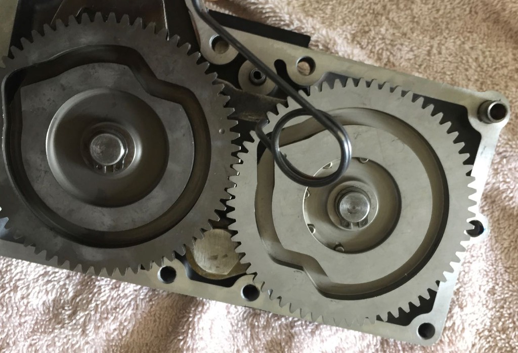

Scud Posted February 26, 2017 Author Posted February 26, 2017 I finally finished up the transmission. The whole misadventure started because I thought I would pre-emptively replace the pawl spring. As it turns out, that spring was seriously fatigued and probably about ready to break. Seals arrived recently, so I was able to get the transmission back together and installed. Also put in the Hyperpro shock, since I moved the Ohlins from this bike over to my red LeMans, which had the Hyperpro on it. Soooo glad to get the transmission off my bench. ...and a shiny new aguila. 1
