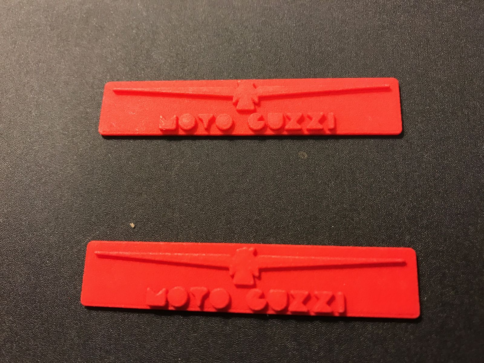

docc Posted December 7, 2016 Author Posted December 7, 2016 Well, now, since no one has sent me links to absurdly expensive beryllium fasteners from some Space Program supplier, I'll just have to move on . . . The Agulia badges came today, and they may be the tightest 3D prints I have seen. Now, to decide whether to paint their background silver or make them zinc chromate. The lovely Gambalunga logo (in honor of Luciano Marabese) will be left red. To match my true-and-proper early RedFrame . . . Courtesy of sp838: http://www.shapeways.com/product/ABDSPQG9A/gambalunga-badges-both-no-steel 1
Scud Posted December 8, 2016 Posted December 8, 2016 The absurdly complex restoration of the alternator cover is simply enigmatic. There. I fixed it for ya. As for emblematic... and your emblems... Where are they going? Or did you get all 4? Silver with red bird would probably look good on the ZC cover. That would probably look good on the triple clamp and the porkchops too.

Chuck Posted December 8, 2016 Posted December 8, 2016 3D printing is amazing. We're at about the same stage as when the first Commodore 64 and Ataris came out. It'll be interesting to see where it leads. 1
twhitaker Posted December 8, 2016 Posted December 8, 2016 True that! I remember going to a machine tool show in Chicago some 20 years ago. A company was marketing a 3D printer that worked by cutting sheets of paper, adding glue, and layering it upon the previously cut layer to make the model.
